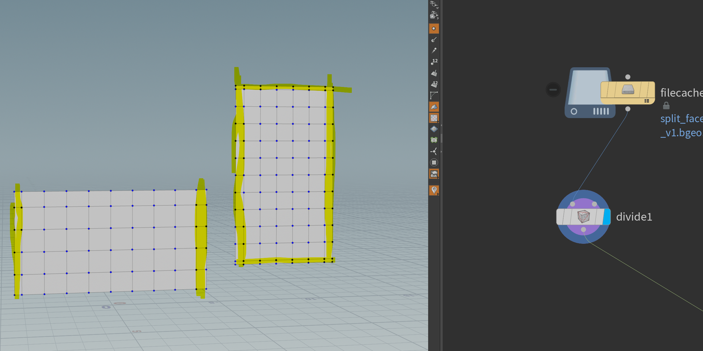

Thank you both, I think I've explained myself very badly, but here are some images that show the problem of using divide and subdivide. They both produce uneven faces which wouldn't work for my use. The grid was actually just for demonstration, think of it as a completely plain quad face I'm working with. Probably the answer is I should find a way to not get to this position in the first place, but the third image is what I'm looking to achieve.
Thanks!

Just in case anyone was interested, this quad fill node in the modeler plugin suite does what I was looking for.
Modeler tools [alexeyvanzhula.gumroad.com]
