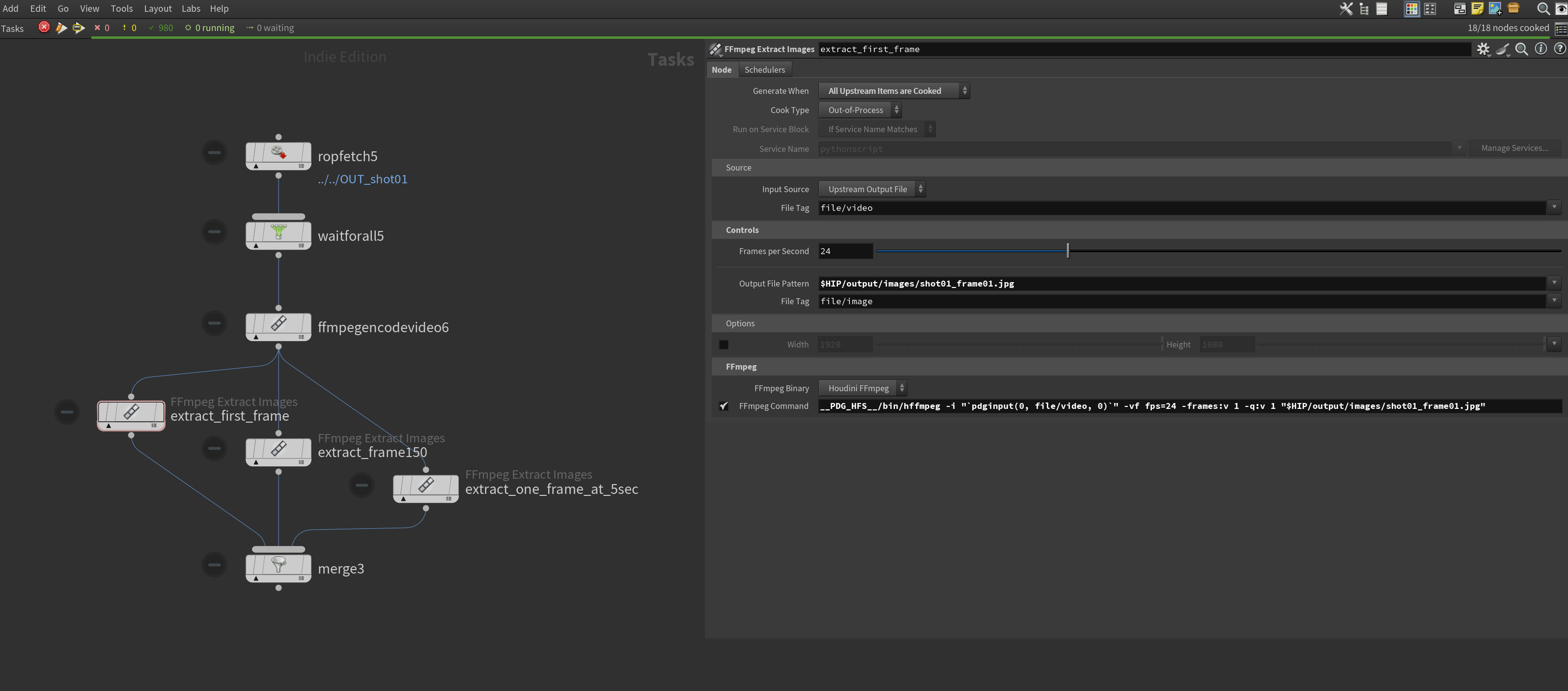

So my solution so far is to add ffmpeg expressions to the FF mpeg Command parameter on the ffmpegextractimages node.
I got these variations working so far:
Extract first frame: -frames:v 1
Extract specific frame (frame 150 in my example): -vf "fps=24,select='eq(n,150)'" -vframes 1
Extract one frame at specific time (at five seconds in my example): -ss 00:00:05 -vframes 1
Bonus to set the best quality on image: -q:v 1
Example of the full FFmpeg Command for extracting the first frame:
__PDG_HFS__/bin/hffmpeg -i "`pdginput(0, file/video, 0)`" -vf fps=24 -frames:v 1 -q:v 1 "$HIP/output/images/shot01_frame01.jpg"
