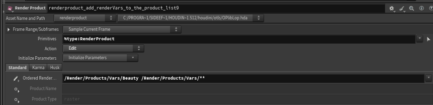

Add your preferred rendervar first in the list, then use wildcard for the rest.
Screenshot 2025-11-12 154926.png (31.3 KB)
