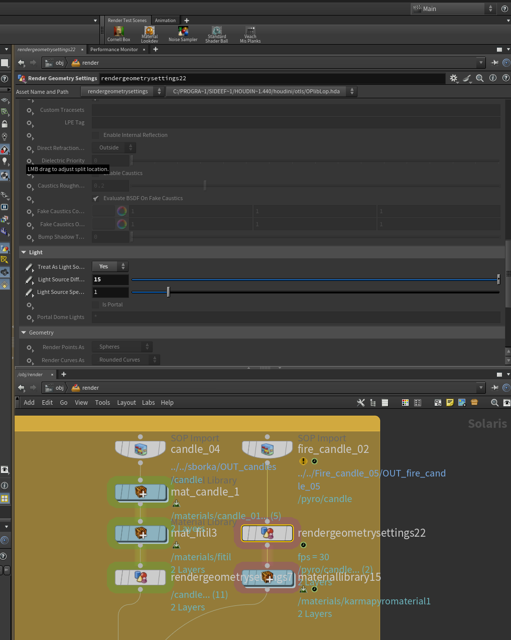

When the flame:
is visible but does NOT emit light → everything looks clean and stable
does emit light (emissive flame / fire lighting the scene) → severe noise appears
The following become extremely noisy:
Beauty
SSS AOV
Glossy AOV
Reflection AOV
The noise does not converge, even with very high sample counts.

Tested with:
Karma GPU (XPU)
Karma CPU
Render comparisons attached
I’m attaching the following renders for direct comparison:
Beauty render at 512 GPU samples, lit by standard light sources only
→ normal result, SSS behaves as expected
Beauty render at 2048 GPU samples, where the candle flame is the only light source
→ extremely noisy result (Beauty, SSS, Glossy, Reflection)
This suggests the issue is specifically related to emissive fire lighting, not overall sample count.
Observed behavior
SSS looks correct when lit by regular lights
Once fire / emissive flame lights the scene:
Beauty becomes heavily noisy
SSS / Glossy / Reflection AOVs become almost unusable
Increasing samples does not meaningfully improve convergence
Same behavior on both CPU and XPU

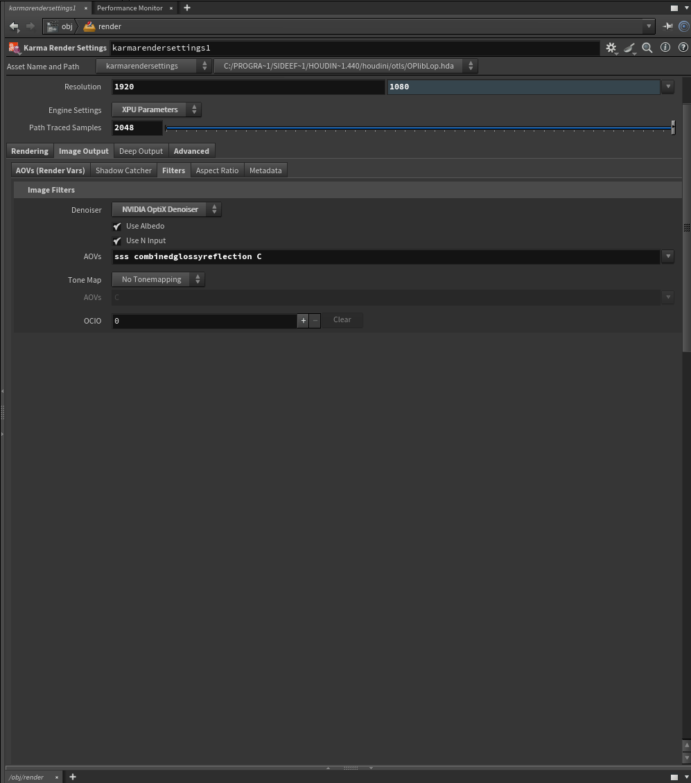

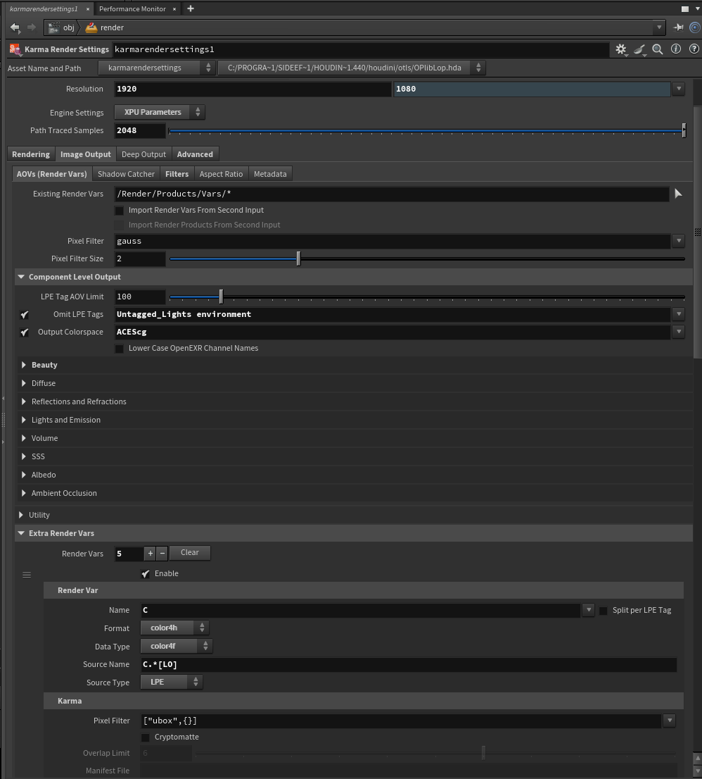

What I already tried
Very high Path Traced Samples (CPU & XPU)
Increasing Diffuse / Reflection / Refraction / SSS limits
Treating volumes as light sources
Different pixel filters
Different emissive intensities
Tests with and without depth AOVs
CPU vs XPU comparison
None of these approaches significantly improved the noise.

Thanks for the suggestion.
I tried using a Geometry Light driven by the fire volume as you described. While it definitely helps compared to pure emissive lighting, the SSS component is still very noisy in my case, especially with a small candle-scale source.
After some testing, I ended up using a different approach: I keep the fire purely visual and use a regular Area Light as the actual light source for the scene. To preserve the natural flickering and gradual fading of the flame, I drive the Area Light intensity from the fire simulation itself (for example using reduced temperature values), so the light still flickers and dies out exactly like the fire.
This gives me much more stable SSS while keeping the temporal behavior of the flame believable.
