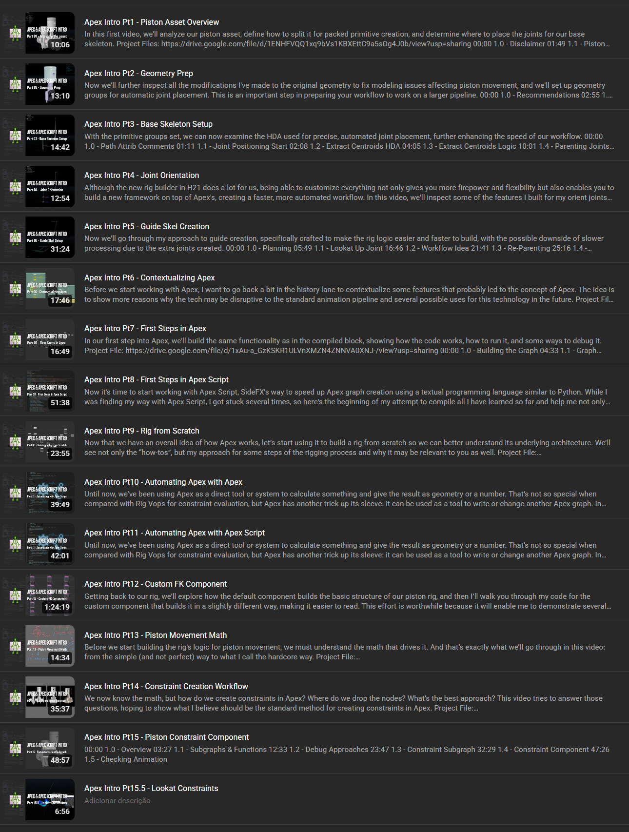

I recorded 20 videos about apex and apex script. 17 will be released on Fri on my YT channel. Hopefully I'll address some of your problems... I know how it feels.
Rig builder is amazing but I believe we must know how to deal with pure apex to customize things.
So I decided to share a bit of what I've learned so far in a series of YT videos. They will be out tomorrow on my channel.

Thanks, @kevinthebright, for adding my link here.
I know the feeling, but there are some reasons I think are worth thinking about before that decision:
I have a similar opinion about the components, that's why I've been building my own. The graph gets messy really fast; that's why Apex Script seems far better suited for the job. But you must have a well-defined workflow, so even after several components are built, a messy graph won't stop you from changing it or adding more features.
