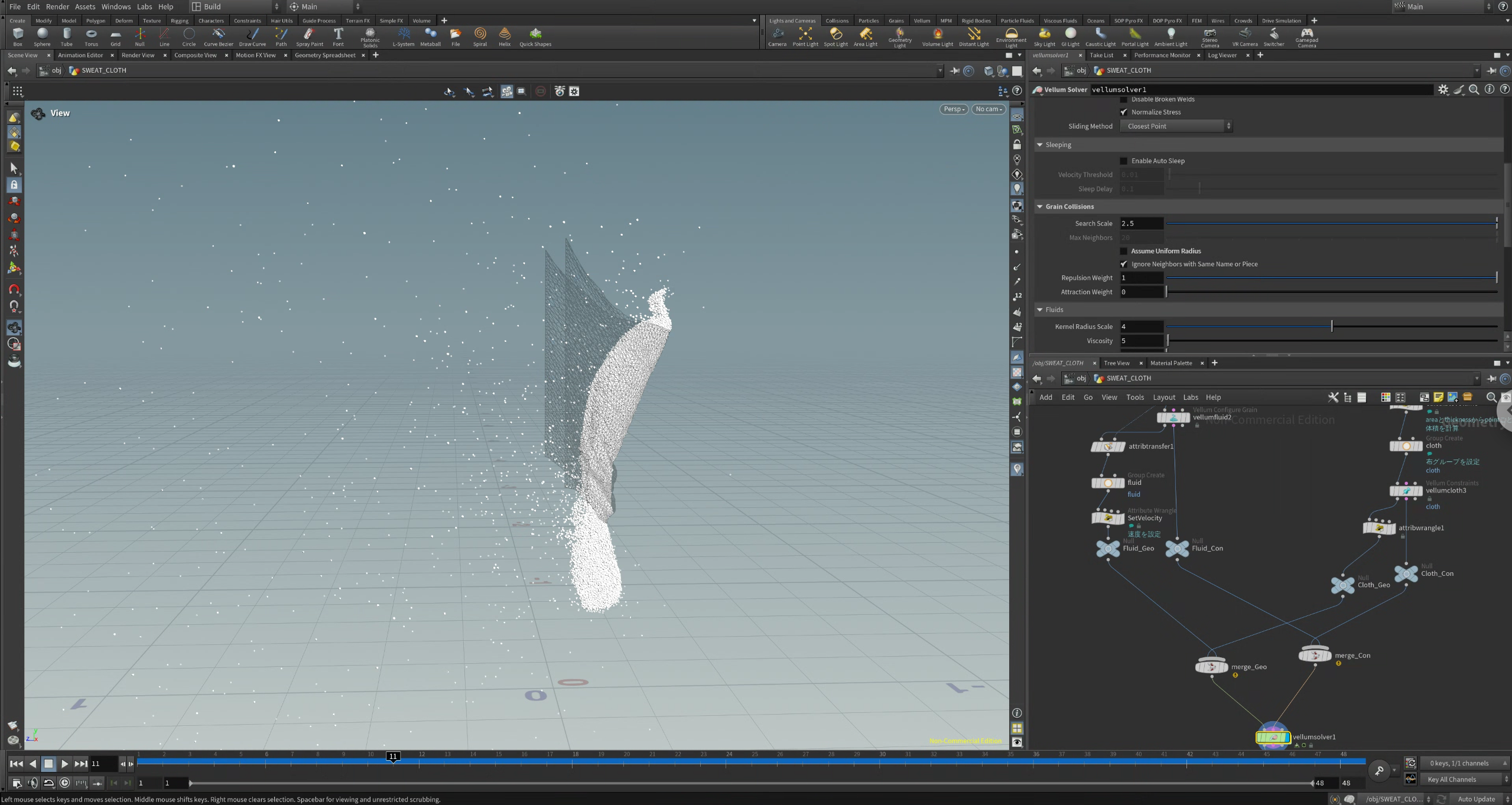

I'm simulating cloth and water using the Vellum solver. When water touches the cloth, I modify the water's @mass and @pscale, but the simulation explodes at certain frames(img2).
Could you tell me the cause?

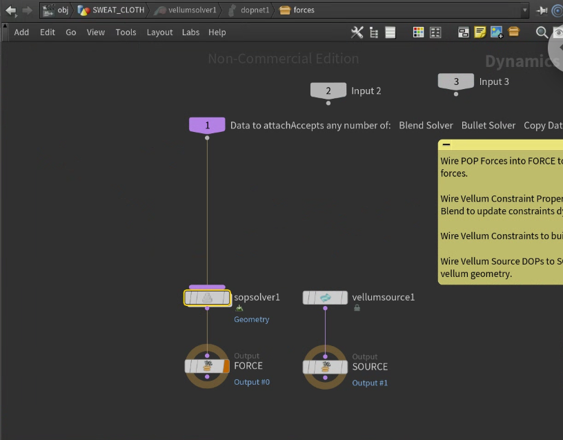

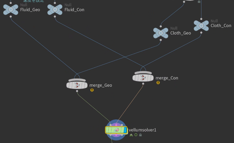

Node connections are as shown in images 3-5.
Unfortunately, I cannot provide detailed code or the hip file, but the implementation flow is as follows:
1. In ”AttributeWrangle1”, for particles touching the cloth (obtained via `inpointgroup(0, “cloth”, @ptnum)`), store the absorbed mass using a formula into the `@mass_loss` attribute.
2. In "AttributeWrangle2", update @pscale and @mass based on @mass_loss as follows:
