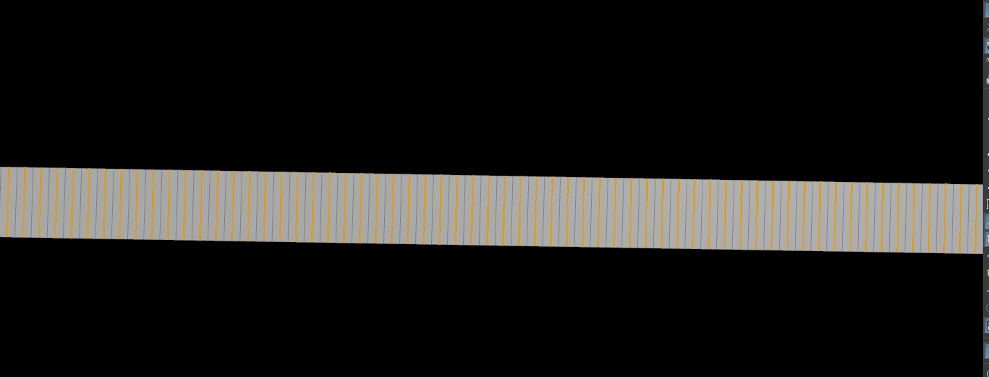

I’m trying to solve an optimization issue by removing every second edge. In Maya this is straightforward, but doing it procedurally in Houdini is incredibly complicated for me.
In the images there are “strips” that I want to optimize. Using a For-Each loop, I have groups with selected edges that I want to delete, but Dissolve either removes the entire geometry or leaves me with only points.
Is there a proper way to do this so that the geometry remains intact but without the selected edge loops?
I’ve been stuck on this for two days and can’t make any progress. I’ve tried almost everything I know but still can’t solve it.
Can anyone advise?
Thank you.
