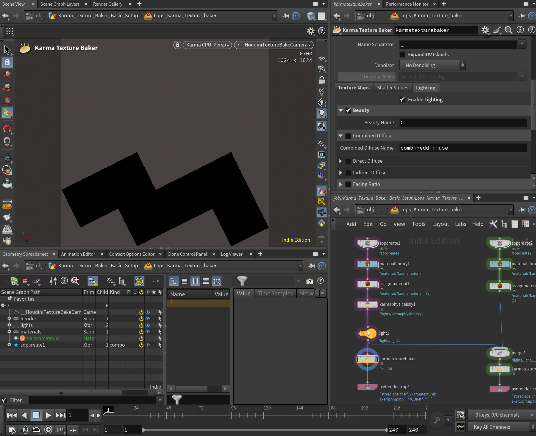

I'm attempting to set up karmatexturebaker to bake lighting to a texture, however simple attempts so far have all resulted in pure black renders. Does anyone have recommendations for how this node needs to be set up to get a lit result?
Following other people's examples, such as this video [www.youtube.com] have not resulted in a lit texture in any setup. I've tested this on two workstations on Houdini version 21.0.512.
I've included a basic setup scene and a screenshot to illustrate the results I'm getting.
KarmaTextureBaker_simpleExample_v01.hiplc (725.2 KB)

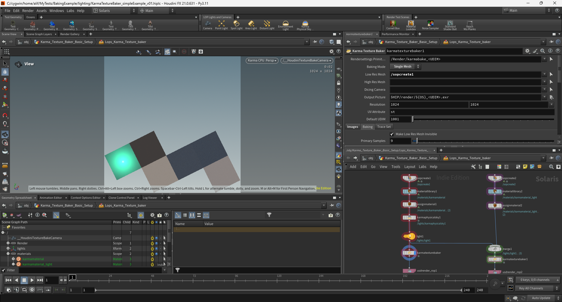

Could you try the example on the latest H21.0 and if it still doesn't work please submit a bug(using the LOG BUG button). Thanks!
13 posts
Joined: Oct. 2015
Ah! looks like it works in 21.0.613, I thought I was on the latest version. Resolved! Thanks for looking into it.
