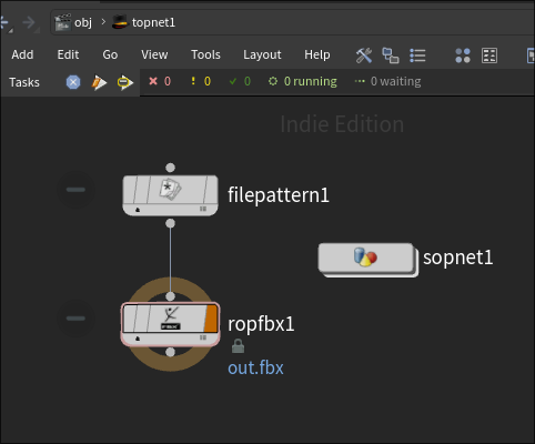

You start your TOP network with a File Pattern TOP and use it to scan your folder for FBX files. It will generate a separate work item for every file it finds. It will create TOP attributes containing the directory, filename and extension.
You then create your SOP network and start it with a File SOP (and follow it up with whatever changes you need, polyreduce, etc). In that File SOP you set the input path to:
To test it, you can cook your TOP network and left-click one of the dots so it's highlighted. Your SOP network will now display that work item's geometry in the viewport. With a selected dot you can also middle-mouse click path parameters to temporarily expand those @ variables and see where they point to.
Now you can add a ROP FBX Output TOP node and select the final node of your SOP network you want to export, as well as provide the output path. In your case, it could be something like:
You then cook the ROP FBX Output TOP. And that's all there is to it.
`@directory`/`@filename``@extension`To test it, you can cook your TOP network and left-click one of the dots so it's highlighted. Your SOP network will now display that work item's geometry in the viewport. With a selected dot you can also middle-mouse click path parameters to temporarily expand those @ variables and see where they point to.
C:/outputdirectory/`@filename`.fbxYou then cook the ROP FBX Output TOP. And that's all there is to it.
