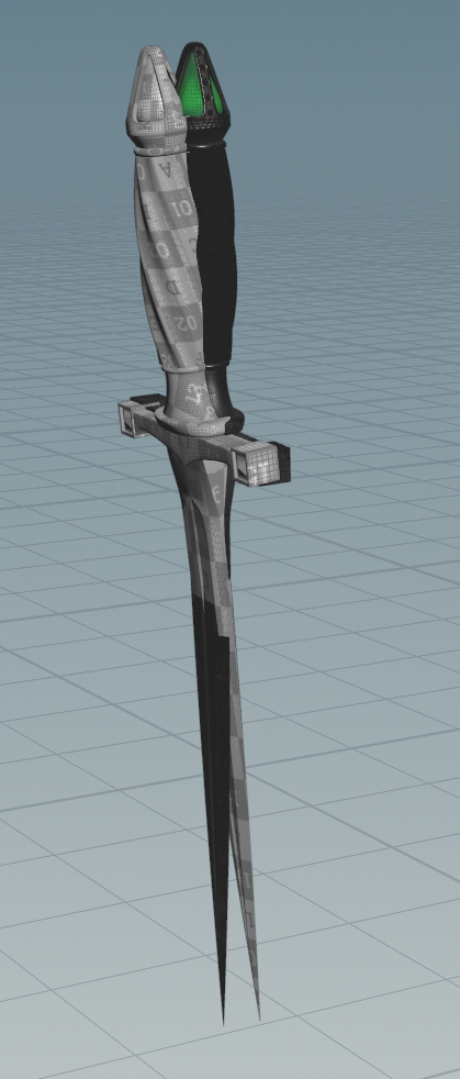

I have two daggers which are visually identical except their orientations do not match.
The untextured dagger is from an Alembic file and the textured dagger is from an FBX file.
Their point counts are identical but unfortunately their point order isn't.
Is there any way I can get the orientation of the textured dagger to match the untextured dagger?

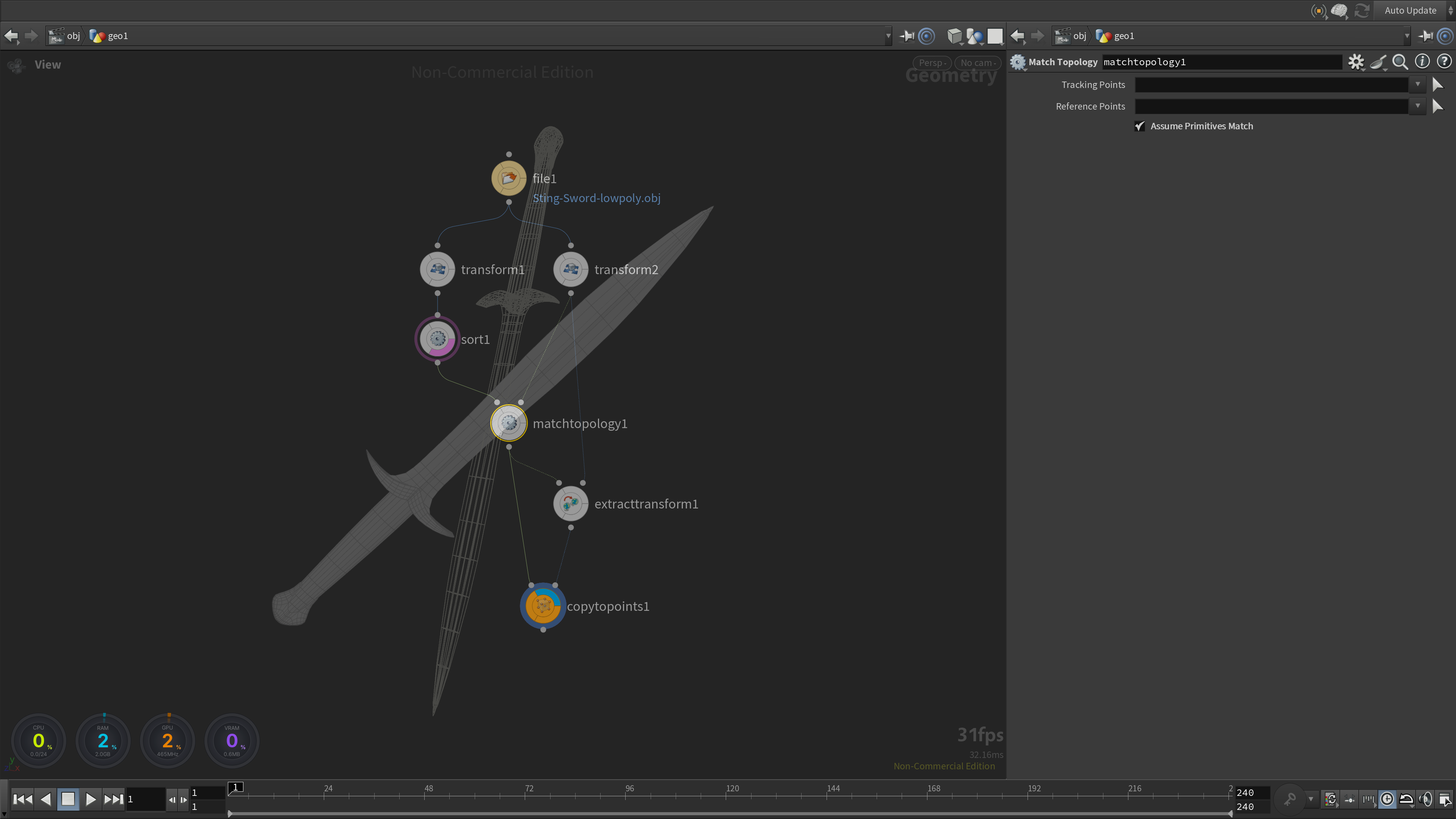

You can use Match Topology SOP followed by Extract Transform SOP to compute the transformation matrix and copy your source geo on the output point from Extract Transform SOP to match the target one:
85 posts
Brilliant!! Works perfectly.
