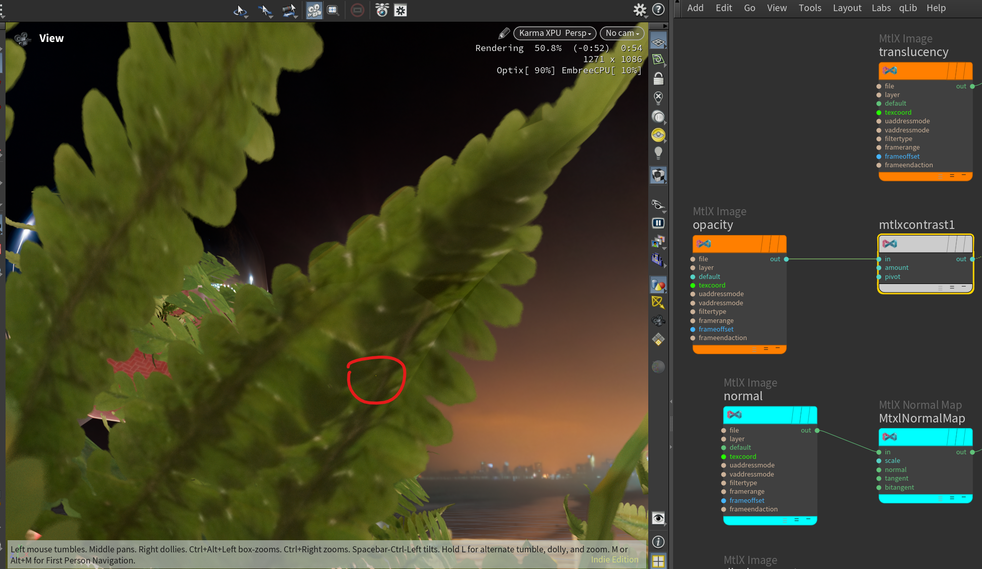

Hi guys,
when I render any plant from below, I get these issues.
Turning of SSS did also not help. It does not matter what hdri I use. Opacity texture is a .jpg with only data in the red channel.
Mtlx_Image is set to float.
The Texture has some grey spots here and there, so I thought it might be the mip maps. I used a contrast in the shader and that almost fixed it. I tried disabling mup mapping alltogether in houdini.env but no luck as well:
# Disable Mip Maps
export KARMA_XPU_DISABLE_MIPMAPS=1
Edited by Kareeem - June 3, 2026 02:46:16
www.rehimi.de
125 posts
Joined: Oct. 2021
Raising contrast to 5 with a bias of 0.01 fixed it. But is there something that I am missing?
It feels wrong that these Megascans textures are all off
Edited by Kareeem - June 3, 2026 02:55:25
