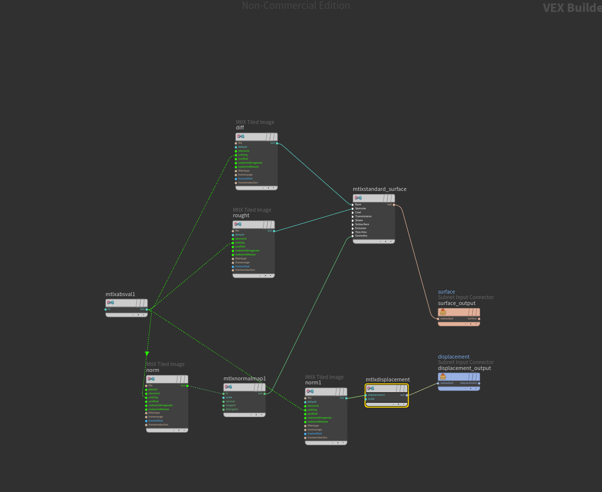

For the tiling issue, I tried using the HexTiled Karma node, but I can't figure out how to use it properly.
The HexTiled node outputs color or normal data, but the textures I'm using from Poly Haven are separate grayscale maps (diffuse/albedo, roughness, etc.). I'm not sure how to connect those maps correctly or whether I need a separate HexTiled node for each texture.
