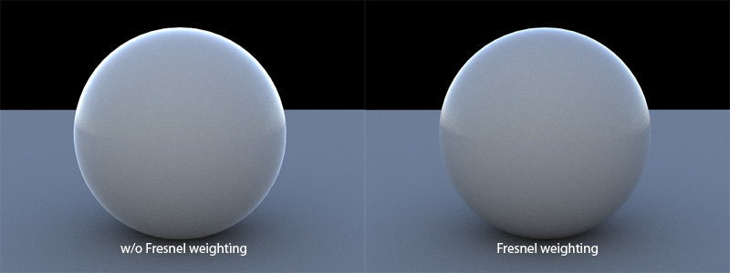

fresnel weighting is definitely better than simply combining the two components - see attached sample. But I'm also interested in what exactly albedo() means.
also, what exactly happens when I sum two BSDFs? is the result of each calculation added or something else? interesting to know
Agreed – that's kind'a what I use too. Unfortunately it doesn't answer you initial question: is it energy conserving? – my guess is that it's probably close to being energy conserving but not guaranteed.
