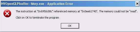

This is the error message I get when starting Houdini. After I click ok the
program exits not getting past the loading screen.

I don't have a clue. Maybe if you would tell us what kind of hardware you have, specially the videocard, which version of windows you are running and which version of houdini you are running, someone might able to help you. For now, it just might not be your day, wrong direction of the wind or who knows…
1533 posts
Crashes of this sort have typically been reported when people are having some graphics driver related problem.
Others have also reported luck trying to correct this problem by running hkey as admin (assuming you are on windows).
As pagefan pointed out, until we get more info, it'll be pretty hard to tell.

The title bar of that dialog box says: “NVOpenGLPbuffer” so the one that's actually crashing is the Nvidia driver.
Try adjusting some nvidia driver settings in the advanced mode. For example I use to turn “Threaded optimization” to Off as many time it crashed both Houdini and SynthEyes.

Just sharing my two-cents worth. The Nvidia graphics driver is quite old and not exactly stable (version 77.76) based on reports in the Nvidia forums.
Your Windows XP does not seem to be updated to Service Pack 2 (SP2) or the current Service Pack 3 (SP3), you may want to update it to SP3 for performance improvements and stability. You will find this update in Windows Update (under Start Menu).
Lastly, if after trying out the driver tweaks suggested by digitallysane above does not help, you may want to update the graphics driver to the recent WHQL version (178.24) here: http://www.nvidia.com/object/winxp_178.24_whql.html [nvidia.com] (Please note that this link points to the 32-bit XP version of the driver).
For me, I will usually check if I have updated the machine's Windows XP to at least SP2 (or currently SP3) and the recent WHQL build of Nvidia graphics drivers if I encounter crashes such as those you encountered.
