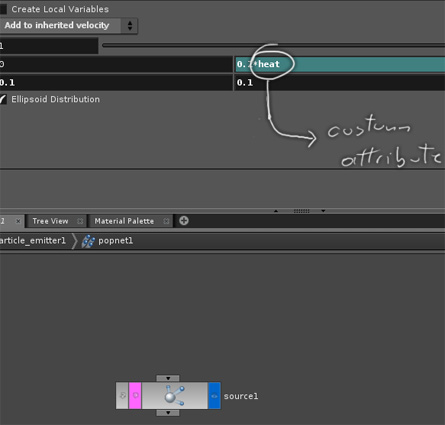

How do I use attributes in an expression?
I want to drive something in a POPNET with an attribute. But just typing in the attribute's name won't work. I read something about using the point() expression but I can't find anything in the help.
Would be nice if we could just drag stuff in. xsi style. dumdeedum. :roll:

Thanks, it's kind of working but I don't really understand why and why not.
-$HEAT does work (no error) in the velocity node but not the source1 node. (error) Why?
- $HEAT doesn't create an error (as far as I can tell) but doesn't create an effect either. All particles have the same speed.
But…all the colors are transferred to the particles!?
And the HEAT is also transferred to the particles, which is good because thats what I want too but didn't specify, yet. (visible if I switch on my custom HEAT text in the display)
Also, what does the $FF==1 mean in the Activation of the velocity node?

:idea: I think I got it! :idea:
・My attributes are data connected with points.
・If a “channel” is not about points it won't accept the $attribute as a variable. I have to extract its value first.
・I do that with a point() function.
So, I typed point(opinputpath(“.”,0), $PT, “heat”,0) into a channel of one of the nodes and bingo it works.
But opinputpath(“.”,0) only gets the path of the node's input. How do I get paths of any nodes? I don't know the syntax for it and can't find it in the docs.
Can I right click on a node or something and copy-paste the path?
