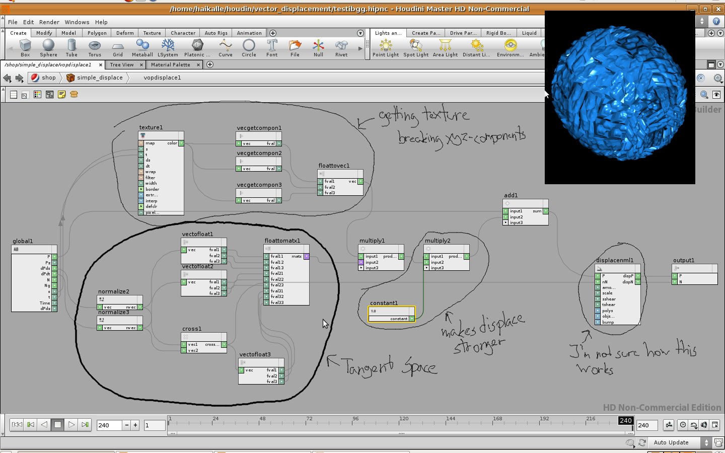

Thanks so much for that information. Here is a update. Good thing that you can see displace. And also good thing is that it's not only up and down but every direction. Bad thing is
that it dosen't look any how it should look like. Here is a picture
I'm not sure what P and nN means in displace node. I tried to understand that
P would be surface postition and nN would be the vector which direction I want to take my P position but it dosen't seem to work like that.

Now it is working. If someone likes to try I can put it here on the forum. Now houdini works perfectly with this program.

Here is a node tree. I added Normal map. My only consern is that did I add Normal maps normals right way or not. In this node I'm just adding the Displacement normal and Normal map texture normal together. If there is any better way do it If anybody can help.
I know that I'm doing something wrong because I get these black lines in my render.

Do you have Displacement Bounds setup? Go to the little gear icon on your object node, choose Edit Rendering Parameters. Then under Mantra9.5->Shading, add Displacement bounds to your object by clicking on the right pointing arrow and click accept.
Set you Displacement Bounds to the same value you have in the “scale” parameter of your shader.

Thanks silvina. That was one part of solution. I have been working with psyborgue who is a user of 3d-coat forum. And he was able to fix this material and now it working corretly. Everybody who wants this material can download it from:

Has anyone noticed that the shader setup doesnt do negative displacement correctly, it always displaces in a positive direction? Im trying to solve this issue just now but i cant see where its going wrong.

As for negative displacements from a texture map that goes from 0-1 (all positive values) you will have to rework the texture map values before it goes in to the Displace Along Normal (which does exactly what the name states: pull surface along the surface normal direction).
See the existing displacement by texture material for one method. I believe there is a menu option for displacement direction.

The problem isnt quite todo with remapping/fitting our image to between -1 and 1 etc.
For example
If I use just the blue channel to displace with the displacement direction is correct i.e it works positively and negatively , but as soon as we use the normal direction defined by the the rgb values in tangent space the displacement direction is always positive.
The results of the displacement look correct for the “positive” direction which is why the examples shown work, the only problem is the inverse direction of the down displacement creating more positive displacement.
This looks more like a normal direction issue rather then a simple texture remap that defines the amount of displacement.
Just to be sure I tested this with that same up down set up as in the “simple displacement material” and there's no change in the direction.
Any ideas why the tangent space normal direction would be doing this? Im still trying to figure this one out. If I get any further I will lets you know.

Afew more tweaks and I will post the shader update, im currently trying to figure out the best approach when using exr maps that are black = 0 and maps that use 50% grey as 0.
Cant quite get the exact values i need from it, its close but not quite right. From what i read in the 3dcoat forum, the 50% grey = 0 image maps are normalised and will make it trickier to get the displacement amount. these need the usual offsets as well.
but the black = 0 maps aren't normalised so should just need scaled down …. but doesnt seem the case with my modo test displacement files. These exr files support negative values and dont need offset like the 50% grey image maps.
Almost there.
Nick
