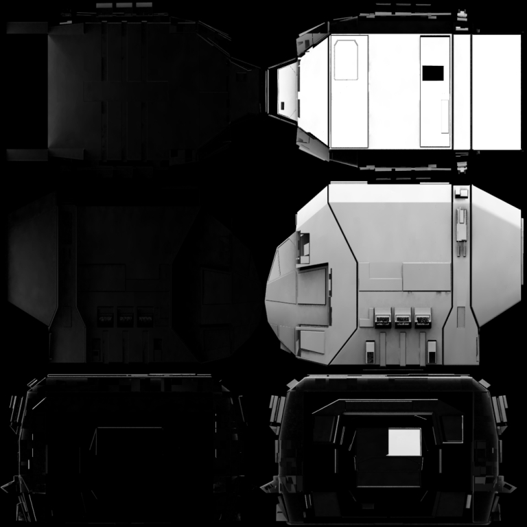

If you want to use this for a texture map to help control where dirt and grime might go, you need to have all the sides “lit”. However it appears that when you bake the AO, it shows the “light” from the POV of the camera, and the other sides are dark. Which makes sense. Is the correct approach to make several shots from different angles, then combine the different parts into one final image?
Currently I'm getting something like this:
However concievably I could just make 2 more renders, each with a different camera position, and then use the appropriate “lit” pieces to replace the dark ones so I get all the sides lit up.
Is that in fact the right approach or am I completely misunderstanding how this is supposed to work?

Never mind I'm an idiot. Fiddling with the GI Light shader settings seems to fix it - setting the Maximum intersect really low does the trick.
