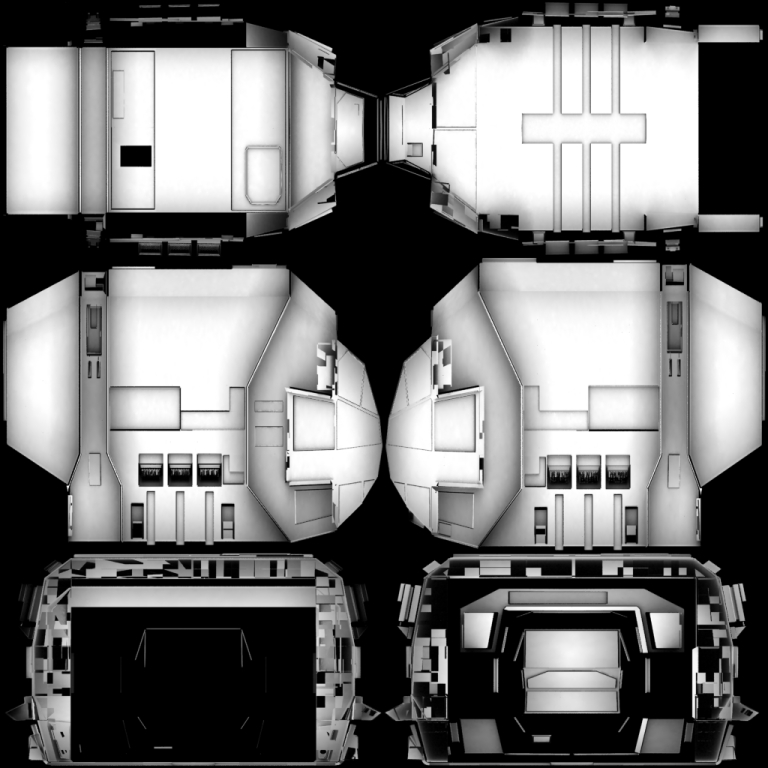

I was able to generate an AO map that conforms to my UVs, however there are areas in the image that seem to have artifacts.

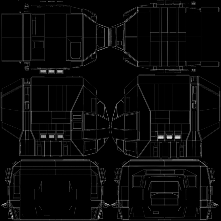

The UV's look something like this:
When it's rendered it looks something like this (camera is inside mesh at 0,0,0):

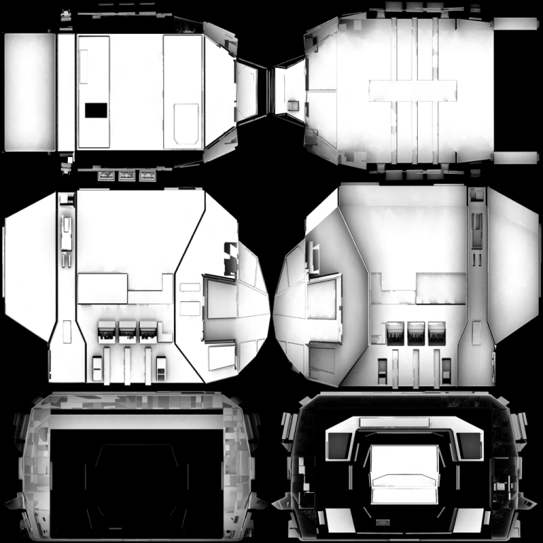

Camera is outside mesh, looking at it:
In both shots, there are square chunks in the rear view (the lower left corner) that don't seem to correspond to anything. I don't know why they show up, or how to get rid of them.

If you are using the Occlusion Material to bake out your occlusion pass make sure you go into the VOPnet and wire in N into the Occlusion VOP's N input. If you don't it defaults to normalize(frontface(N, I)) which results in view dependent shading. Unless you are trying to do something sneaky view dependent shading is bad when doing texture baking.

Yeah, sorry for the lack of detail. I'm using a Light Template, with it's shader set to a VEX Global Illumination shader. No material on the geo object. No other light source enabled.

Wow, that worked like a charm, after your fix for adding the Normal! THanks so much! The rest of the artifacts were overlapping UV's, once I started fixing those, it looked much better. Again, thanks alot for this!
