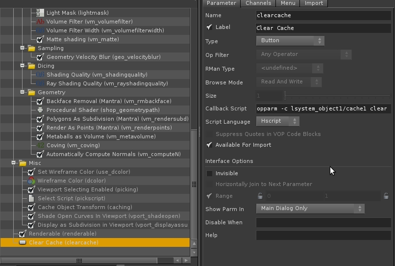

I came accross this recently also, the alternative method is to use a callback script:
opparm -c lsystem_object1/cache1 clear
'clear' is the command for the button, and you can get this info by hovering your mouse over the ‘clear cache’ button.
