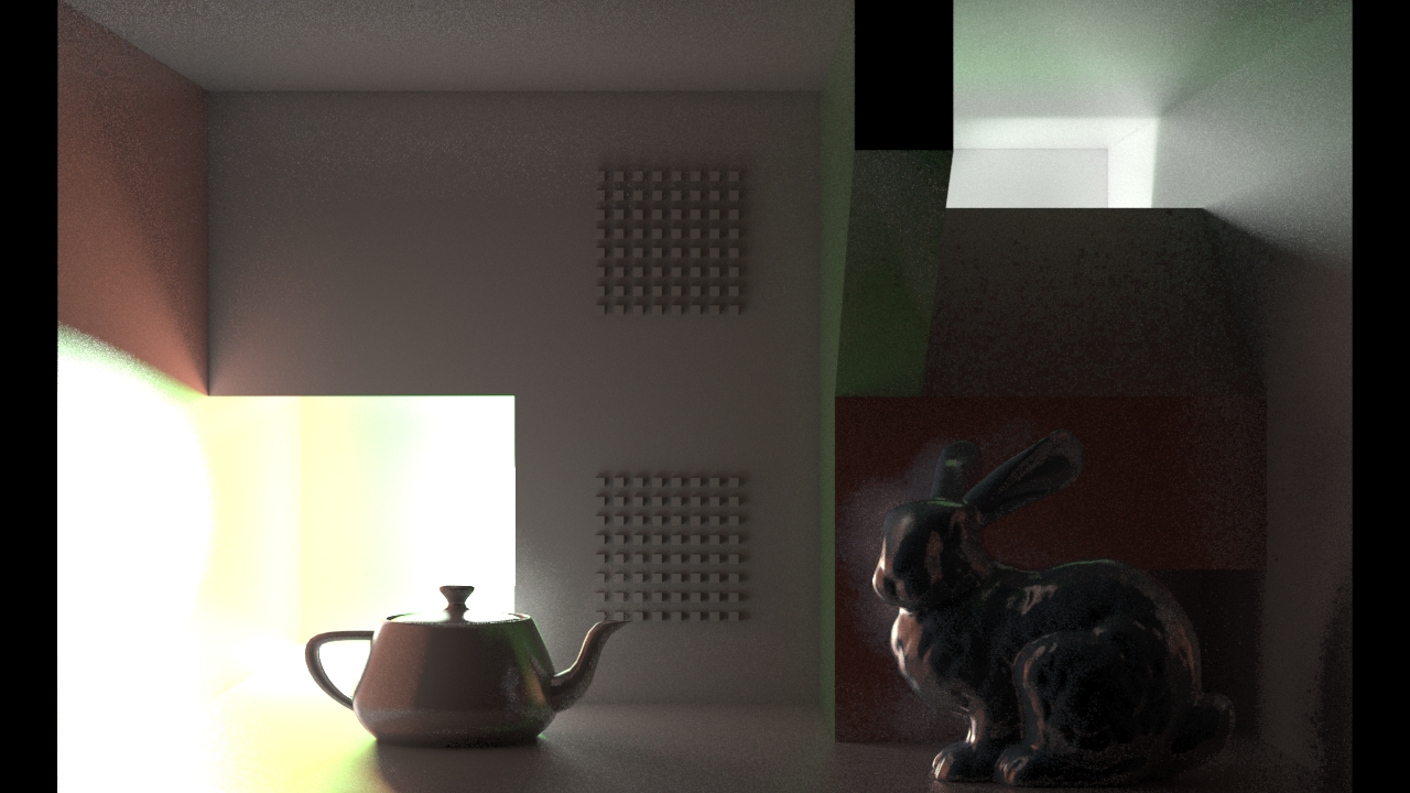

My test environment started as Cornel box… I needed a scene that was fast to work with but also challenging for the renderer, so my cornel box quickly got extruded all over so that I could test more complicated light paths, my main interest being to light things almost completely indirectly because that is hard to solve…
As a result my cornel box now has a tunnel going round the back, and this is where the only light source resides. There are a couple of other features intended to expose defects, but they are extremely likely to appear in an actual shot.
Glossy reflections are also important so the scene has them everywhere (it's all the same shader).
Apologies if it isn't the most pleasing model, it was totally random. In hindsight I would have done it using golden ration throughout

So it seems the biggest two things that we need to have in order to produce a reasonable image in a reasonable amount of time are:
- Better than photon way to cache lighting, something like an Irradiance cache, and use it for indirect rays.
- Reflections to have access to such cache.
Turns out that we can already do this the manual way. There is nothing to stop you from writing your own irradiance cache to point clouds, and use the Gather system to look up these clouds for indirect rays!
What you wont have is as nice a workflow as one that is built into the software by default… most notably generating the point cloud without having to generate another ifd and render sequence. And re the Gather system, it seems like it's going to be deprecated some time and support/new features will cease, such is the enthusiasm for this pbr… That is what is seems like to me anyway.
Anyway that is what I did to produce the following render.
The output of a diffuse bounces shader was written to a point cloud cache from the pov of a camera where the entire entire scene was within the view fustrum.
The raytrace render was used, resolution set to 256x256 (this governs the cache resolution) and the vm_hidden property was also used (forces the rendering of back and hidden faces).
This was then rendered onto the surfaces with a point cloud shader, the result was exported to a variable that is picked up by diffuse and reflection Gather loops.
The gather loops shot 64 samples, this was further refined in the raytrace rop by 5x5 pixel samples. The comparison PBR render was set the same except the min rays was set to 4 and Max set to 32.
Variance antialiasing doesnt do anything at all for Gather loops apart from making it really slow if min samples > 1, so it is kept to default. Doesnt bother me since it clearly didnt help PBR much…. it doesnt like the gradual increase in noise amplitude as the light darkens.
I gave up optimizing the PBR quality because an increase in quality would inevitably require a disproportionate increase in render time. I limited the setting so that both PBR and RT/Gather renderers was roughly the same time.
On a 4 core (ht disabled) i7940
PBR was 48m28s
RT was 43m30s
I will upload a clean scene for you guys to try and achieve a better result than I did with the PBR renderer, but I doubt very much that better quality can be achieved without a heck of a lot more render time.
First is the irradiance cache image, it looks a heck of a lot better than photons although it takes roughly the same amount of time to compute.
Next Is the PBR image… not good. I know you can do better but I cant wait an hour every time to find out.
Then its the raw rt render, followed by a tone mapped and noise reduced version (Neat Video under eyeon Fusion).

I will also post the same scene under the only other renderer I have available to me, Modo. Sometime this weekend… I actually think H will compare favorably.
