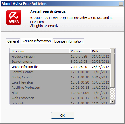

Hmm Im running a virus def file of 7.11.26.40 and im still getting the false positve pop up (thinking that the version numbers increase, I should be sorted
). It popped up this morning after I logged on.
Perhaps you might want to re-mail them edward. If not I will do so. Might get more weight if you do though.
Thought Id let you know. It's not an issue for me. I trust Side Fx, so I have no problems adding that file to my exception list (although thats a habit I would rather not get into.)
). It popped up this morning after I logged on.Perhaps you might want to re-mail them edward. If not I will do so. Might get more weight if you do though.
