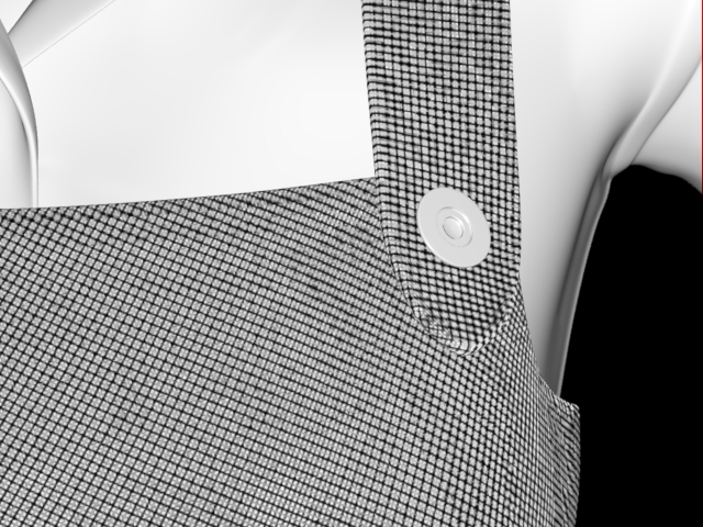

Hey all,
I'm trying to procedurally create cloth. Maya has a really nice cloth material. Does Houdini have something equivalent? I have been rather unsuccessful at creating something that actually renders properly. Gingham seems to be the closest thing I can find. It renders great up close just like any fabric would, but when I back off the displacement starts disecting the object into bigger pieces.
This is what my node network looks like
uvcoords –> gingham –> complement –> displacement amount (of displace along normals node).
Gingham checker size .002
Blur .6
Displacement Amount Scale - .01
This occurs whether I start a network from scratch or use the mantra surface and plug into it.
Any suggestions?
Thanks

Gingham seems to not anti-alias itself very well. This is very apparent for micro-polygon rendering, but almost disappearing for ray tracing, presumably because pixel sampling in ray tracing does monte carlo sampling on the pattern effectively. As a first step for micro-poly you normally crank up shading quality on the object (Render Tab). Next thing would be to take a look on a pattern itself, using the right blur size for a screen space pattern size.

I talked with my professor and his solution really helped.
In the Mantra Render Node under the “Dicing” tab there is a parameter called Z-importance. It is default set at 0, if you drag it up to .5 or 1 it actually helps out a ton. I believe it has to do with the Z-depth of the object. Also the dicing quality inside the actual geometry of the object seems to help.

Both these setting cause the same thing. Smaller micro-polygon on the screen == better sampling of underlying pattern.
