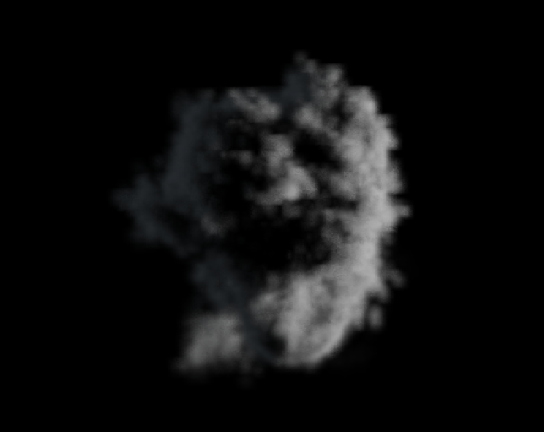

I downloaded your file and modified the density settings. Have a look at the attachment. Is that what you wanted?
It appears that the shelf-tool settings have been changed after v12 was released.
VolcanoEdit.hipnc (681.6 KB)
Screen Shot 2013-05-07 at 10.26.11 AM.png (303.0 KB)

this setting only for viewport?
4189 posts
Joined: June 2012
I'm not sure what you mean by ‘setting only for viewport’
I haven't done the tutorial but I could render it.
Screen Shot 2013-05-07 at 10.54.09 AM.png (94.0 KB)
