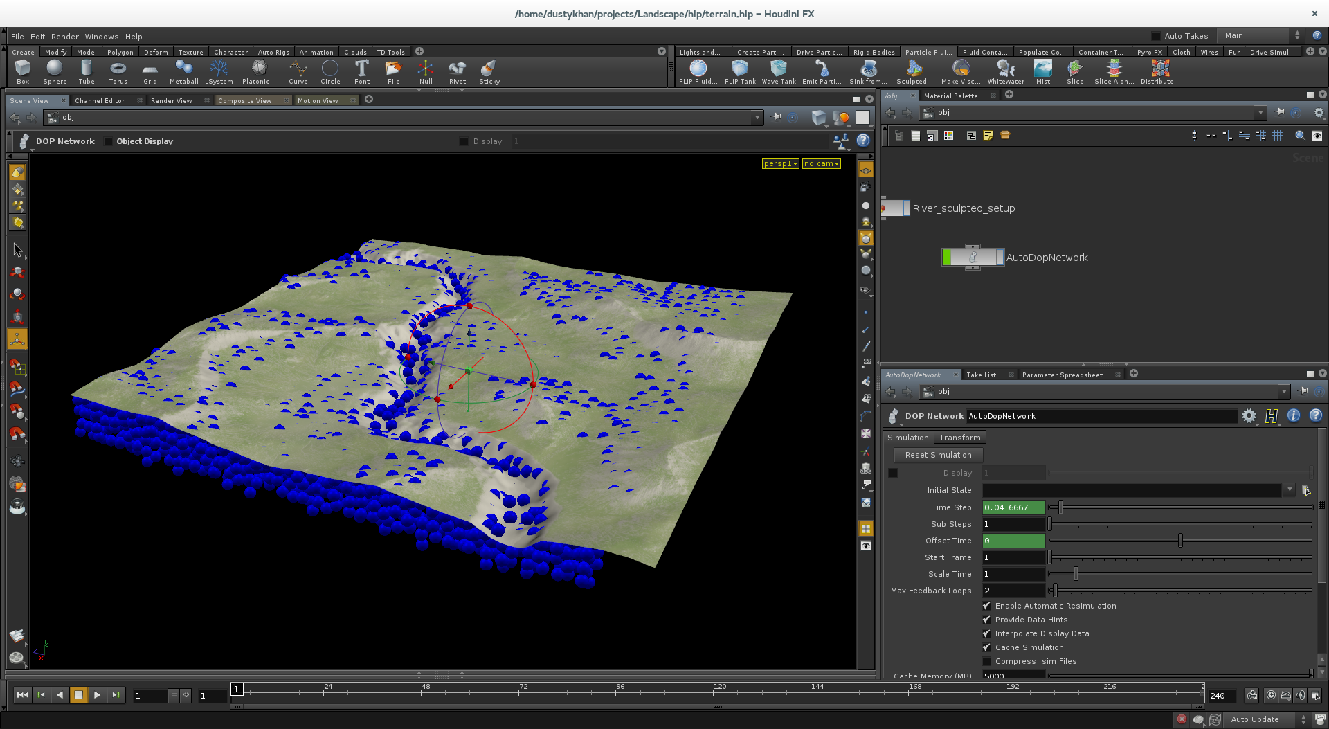

I have created a terrain with a river that I am trying to use the Sculpted Particle Fluid with, but I am having some issues.
It appears to create the fluid the full width of the terrain and not just within the spce between the selected terrain and fluid surface. I have attached a screenshot alng with the file. Any help would be appreciated.

you have deleted part where you add fluid particles in your scene so it is hard to tell what was wrong

there was a problem with cookie sop in “River_sculpted_setup” sop
I have added extrude volume and decreased particle separation from 20 to 1

Thanks for your help, thats much better! Is the reason for my issue due to th scale of my terrain, or is that the shelf toolss dont quite set everything you need to get it working of the bat…?
