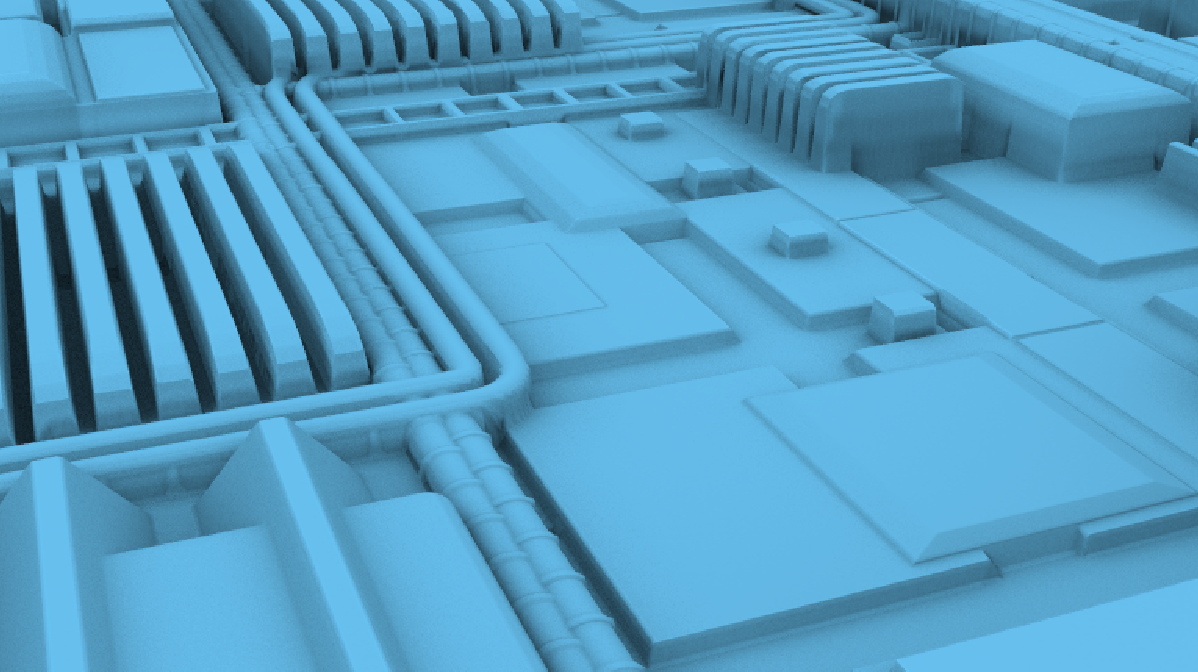

Is there any way to displace the geometry/mesh of an object by an image? I have some displacement maps that I have used in other 3D packages and I want to try them out in Houdini.
I have an image that shows my attempt using a Material to displace the surface on render but as you can see the mesh splits because it is a render time based solution.
I have a box that is flowing into a subdivide node. Now I want to take the result of that subdivide and connect it to the displace-by-map node. But being a new user I do not know what the name of that node would be called.
Can image map geometry displacement be done in Houdini?

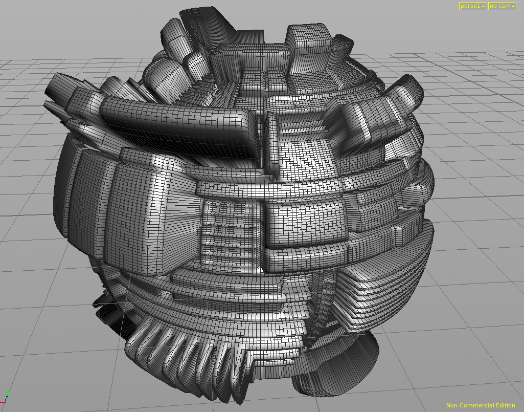

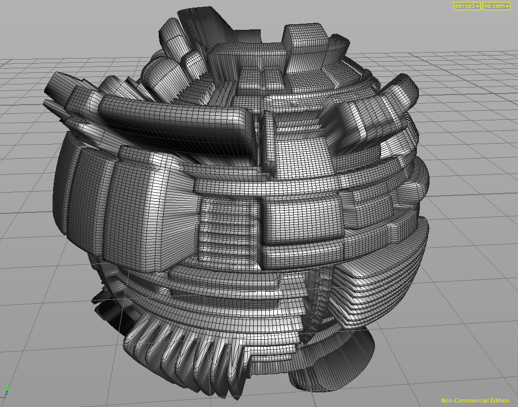

I have added a vopsop to the end of my UV textured sphere object.
When I insert a texture inside the vosop, followed by a displace, I do get geometry displacement. However, there does not appear to be a mechanism for relaying the UV coordinates to the texture node inside the vopsop.
How is that handled?
Do I need to use more than one input on the vopsop?
NOTE: I am using two images, one a baked displace map and the other a companion version of the same map with AO baked into the texture. So I want one map to be used for the rendered diffuse surface and the other map for displacing the surface geometry.
As you can see in the image the displace version of the map has no link to the UVs so it can not synchronize with the AO version of the map.

- old_school
- 2540 posts
- Online
A couple things.
To import uv's in to the VOP SOP network, they have to be of type point and you need to use a Bind VOP to reference the attribute by name and type.
It is common to use the luminance value of the RGB texture map for displacements.
See example file for changes.
