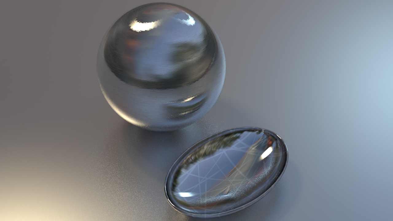

You have couple way to do that , I made a simple project about this for you :wink:
JKSteel.rar (629.7 KB)
Rabiee.Sadjad@Gmail.Com
1391 posts
Joined: Dec. 2010
In this project I made two different material , Brushed Steel and Soft Steel :idea:
