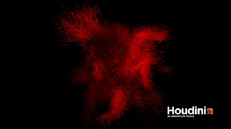

I checked your project , But every things works correctly and I had perfect motion blur !!!
I just open your project and press Render button , Then I take these results !
Rabiee.Sadjad@Gmail.Com
