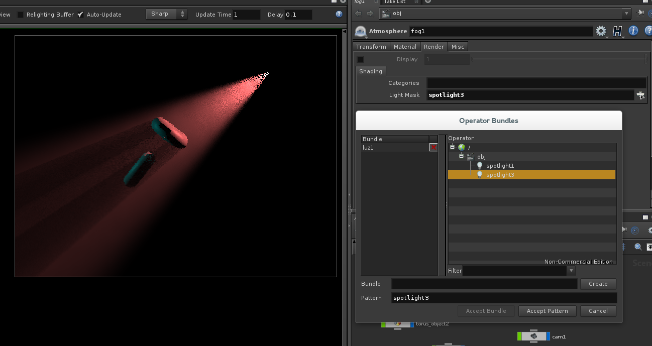

Hi , friends from the forum , i need help with volumetric lighting !
If i got 2 lights and then i create an atmosphere and then i connect a lit fog shader , how can i configure the right configuration that only one light helps the atmosphere and the other one just to lit up the place without affecting the volumetric light !!

Hi.
Try selecting the light contributing to atmosphere in the Light Mask parameter of atmosphere node.

I'm not sure what you mean but you should be able to select Light Mask clicking on the right icon (or entering lights name in the light Mask field).
Is this what you are looking for (see attached image)?
It is working for me on Houdini 12.5.824

I had same problem before , It's only work on Houdini 12 , It should be a BUG on H13 :?

curse. then it is an error in houdini 13.0.447

without any success in H13.0.401 & H13.0.267 :!:
