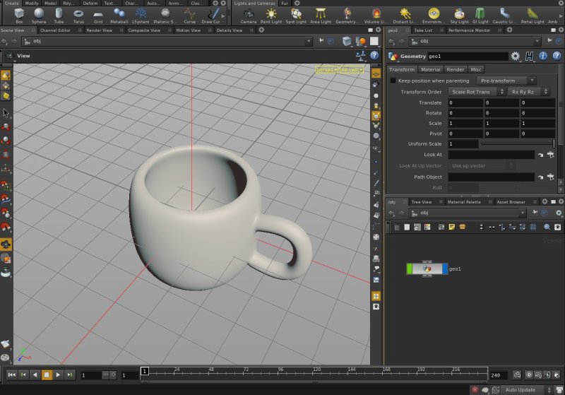

4189 posts
Joined: June 2012
working in H13.0.545
Screen Shot 2014-10-24 at 10.06.13 pm.png (206.4 KB)
175 posts
Joined: Sept. 2014
Works for me.
