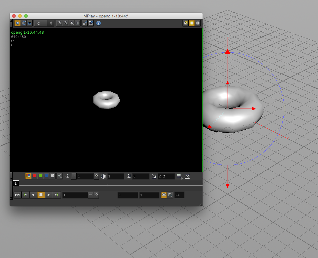

I found another problem with the display on the Mac Mini. The viewport will not display particles at all.
However, if I use an Open GL output node and configure it for GL2.1, which OSX does support, I see that my render does indeed show particles and shadows while the viewport does not.
It seems that Houdini is too conservative in detecting the capabilities of the OpenGL for the viewport. The Scene Renderer for the 3D Viewport only detects GL 1.1 when it should detect GL2.1.
I think this might be a bug.

Thanks for the reply, I get the same results with your file. If I leaver shadows turned off, I can get a render out of OpenGL, but as soon as I try to use shadows everything turns white.
I was hoping to leverage OpenGL for faster renders but without working shadow support this option seems very, very limited…
Games and iPad/Phones seem to have better OpenGL support than Houdini, at this time.
