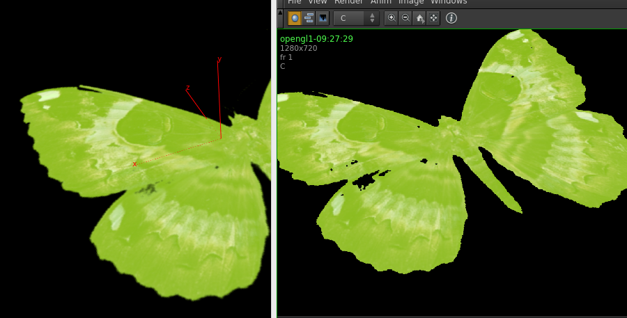

Hello,
How to render as smooth as view port for Opengl Render node?
Thanks!
ogl render.png (259.3 KB)
8155 posts
Try changing the Anti Alias parameters on the Display Options tab.
683 posts
Joined: Nov. 2013
edward
Anti Alias may not worked.
ogl.hipnc (276.7 KB)
