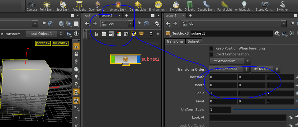

Hi Damian,
I am attempting to do what you said here but I can't get it to work. I have a very simple cube that has a transform on the OBJ level. I then created a digital asset out of the cube at the OBJ level (I did not dive inside, create a subnet of the sop and then create a DA inside the OBJ). I brought the digital asset into Unity and I cannot see the animation. Exporting it as FBX does indeed yield the animation. I can't seem to find a decent tutorial on how exactly to get this done. It would be great if someone could give a simple outline on how this should work. Should the keyframes go in the first set of parameters in the picture below? Or in the second picture's parameter set inside the subnet? Also what are the limitations of the animations. Can SOPs be added and then have their parameters animated and then baked inside Unity? Or do only transformation keyframes work (scale, rotate, translate)?
Thank you
Thank you

As I stated in the previous post, only OBJ-level animations are support. SOP deformation animations are NOT supported in Unity.
What I should have been clearer about is that the animation has to be WITHIN your asset. You cannot animate the position of your the asset instance itself in Unity.
Now, I'm not too sure I understand what is going on in your screenshot so I'll just outline the setup from scratch:
OBJ Subnet <— This guy should be your asset node.
___OBJ Box <— Animation should go on this guy.
______SOP Box
______SOP Box
