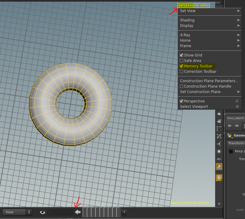

It's there (memory toolbar) just turn it on. Go the the first little yellow rectangle in right top corner of the 3d view (switcher for the view type) and turn it on. You can save camera view (position) and also screenshot (snapshot) independently.

Snapshot works for render region too. What else you are missing?
