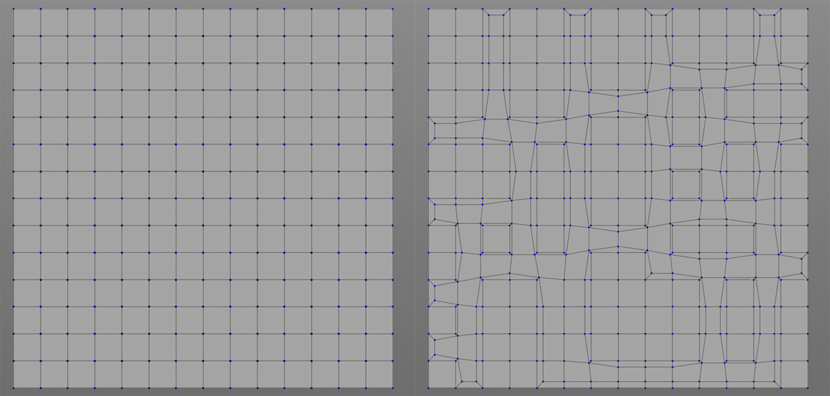

Hello,
I have issues with the inset on the PolyExtrude SOP. Please see the image. What is the proper way to get a clean inset? I tried both “Average Positions” and “Use Normals”, neither gives a good result. Using Scale instead of Inset also doesn't fix the problem.
I remember having similar issues with the bevel tool. Are these tools completely broken? I consider them very standard and very important for all sorts of (procedural) modeling. Any help is very appreciated.
648 posts
yeah inset has been broken in a number of ways for a long, long time…
the attached pic is from an RFE that's over 5 years old now.
Hopefully it got some attention in H15.

Hello, the Polyextrude Node has be drastically improved in H15, you should give it a try!

There's also PolyExpand 2D for more complicated cases of insetting where the result may end up with multiple “islands”.
