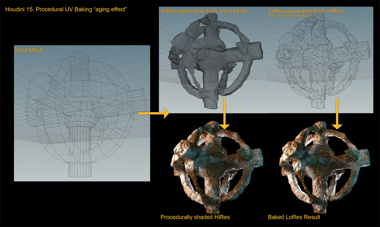

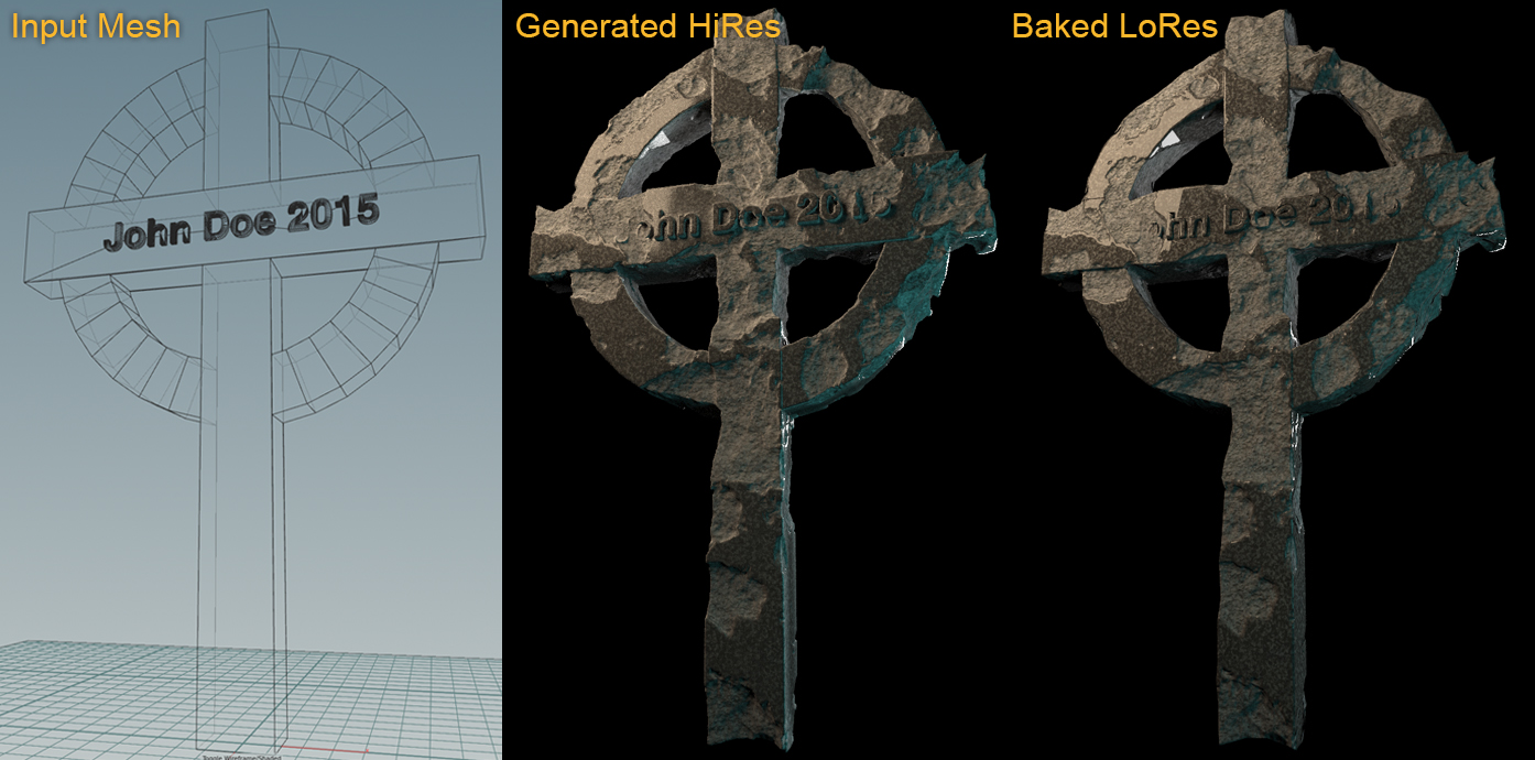

@MagnusL3D: These tests are looking terrific
Could you explain a bit about your method for the procedural weathering (eg. VDB operations, etc.)?

@MDavies, Thanks ! it's been a bunch of fun trying out.
Looks like alot of nice things are comming. Btw I still havent been able to output TGA's for the seperate image planes and I seem to recall you saying it was possible, is this something that could be posted as a example ?
For the weathering effects I just use the “VDB from polygons” and then I hook up a “Volume VOP”
Inside the Volume VOP I put in a bind VOP for the “surface” (make sure you did fill interior previously) and a bind export for the “surface” aswell, hooking the bind and bind export togeather, adding a “Add VOP” inbetween that also gets hooked up to a Turbulence VOP.
After that back out to SOP level and convert the VDB to polygons.
Then generally I put down a attribute transfer between a “un-weatherd” hi-res and the generated “weatherd” mesh, usually I do this with the “Cd” attribute so it is easily to see, changing the distance for the transfer to a low level makes the worn parts a different color than the not so worn. This attribute can then drive the blending between materials in the shader.

Oh wow, I looked at the pics mostly and just glanced over the text, no wonder I didn't notice that these are obtained procedural. They look great as they are and I'm guessing if in need of a “hero” object you can easily export one of those dense meshes and further sculpt it in Zbrush.
I'd be curios to be able to make a comparison between the level of control you have here and that of Zbrush's noise generator.

Yeah I wish there where more build in noise patterns in Houdini even though you can come pretty far with whats already there. But my “dream” with this, just for personal fun, is say that you want todo a cemetary and instead of Z-brushing 100 run down tombstones, you just procedurally generate them. Just press render frame range 1-100 and put $F in your noise offset.
