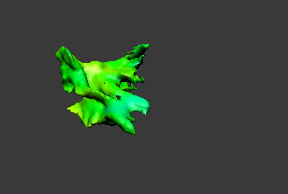

I am searching for a workflow to animate morphing of 10 or more models of a cloud one into other. When the morphing animation is completed, I need to transfer it into Unity5 and show there inside a scene.
1. Is Houdini able to morph several different models with vertex colors one into other?
I have FBX files with static vertex colored meshes of a cloud, like on pictures attached, showing three different states. They can be represented with particle system or meshes, just to show how cloud develops from one state to other.
2. Can that animation from Houdini be transferred to Unity?
If there is any tutorial showing a similar case, I would like to check it.
