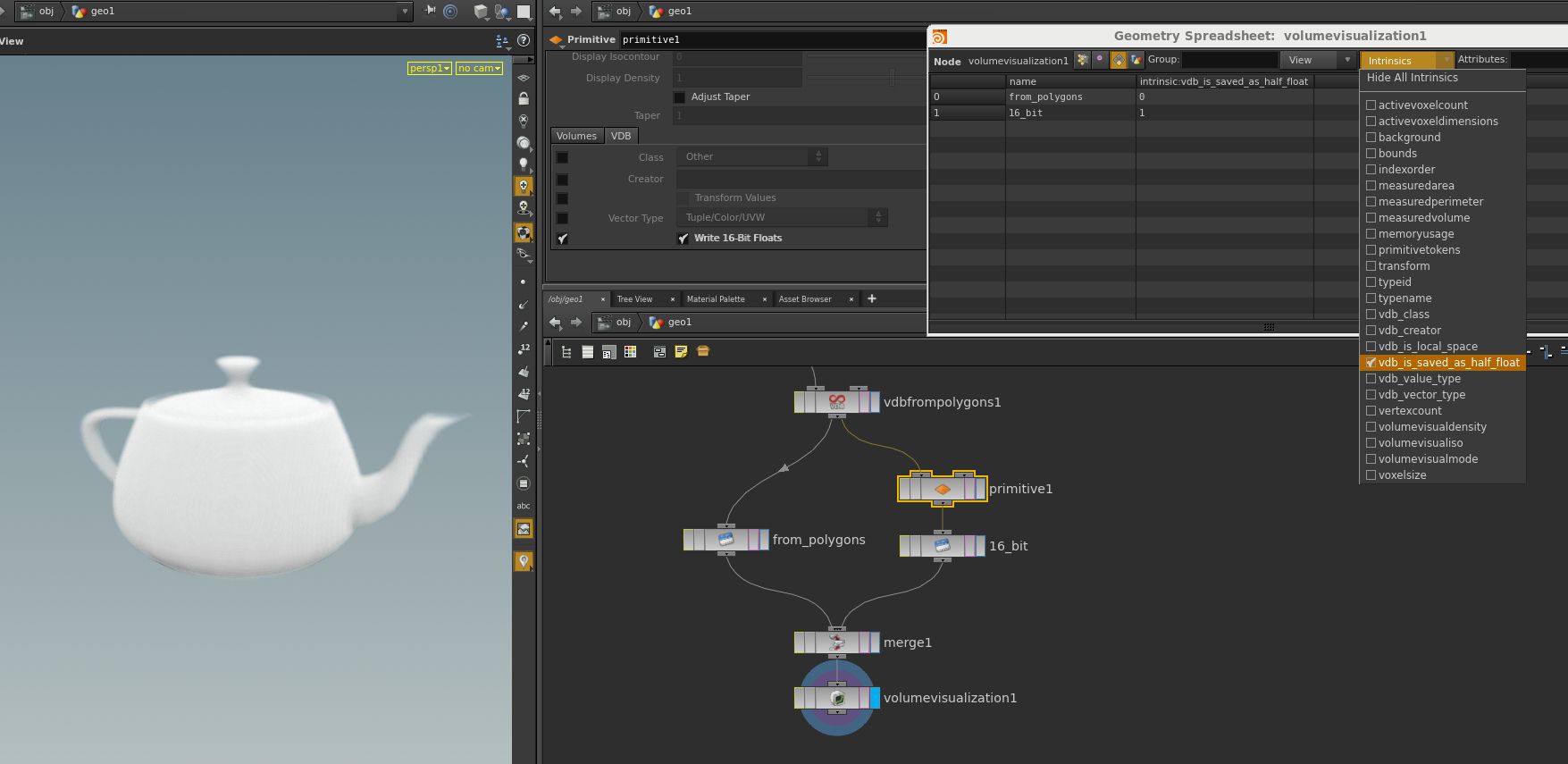

in the spreadsheet, look for an intrinsic attribute called “vdb_is_saved_as_half_float”

I think with VDB they are never stored in memory as 16-bit, it is only when they are written to disk and save half precision is enabled.
