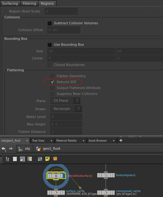

does anyone know how to turn off the function “rebuild SDF” in the new particle fluid surface node? From Houdini 14 I know that this is causing much of flickering. But obviously I can't access this option, its greyed out.

hi there,
just tried it + what works for turning it off
in the particlefluidsurface is checking the ‘Use Bounding Box’-box just above it, then you´ll have access to the rebuild sdf checkbox there, but as I´m reading the info of the particlefluidsurface node it says one is supposed to turn it off in the flip solver instead, if I got it right…
but better double-check
cheers!
