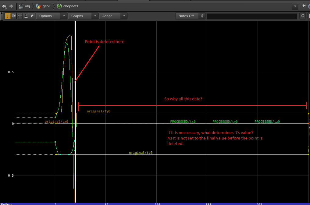

Hi all,

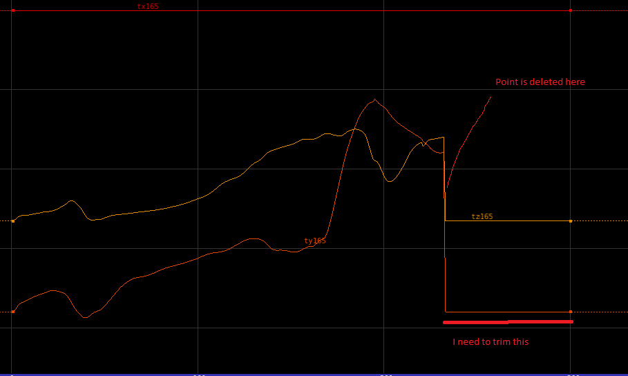

I have some motion data that I'm trying to smooth out by using a filter in a CHOP network. Generally this seems to work ok, except that many of the points on the geometry will be deleted at some point in the animation, yet their channel data continues - and not a continuation of the last value that channel had before it was deleted (if anything, it looks like it reverts to the start value for some reason).
So, how do I get the channel to just hold the value it had when it was deleted?
Currently, using a trim is the only way to get it to hold the correct value, but I don't know how to do this procedurally, but I'm convinced that I'm missing something really obvious here.

Another thing I noticed, is that they revert to their start value after death when you have Organize by Attribute checked on. Without this on they seem to go to zero (or some other equally useless value.
So…is this considered a bug? In any case, how would people go about getting a channel to maintain it's value after it's deleted?
