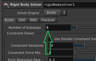

Ok, thanks. I think I will use the bullets engine after all. The funny thing is, bullets has the same “flaw” in Houdini, as it has in C4D. One might think that cranking up the Number of substeps value would refine the animation. and it might in some cases. But in both Houdini and in C4D, when this value is increased, bouncing starts to behave weird. Like dropping a normal ball filled with air, then suddenly the ball is filled with led. Bouncing stops abruptly. Happens with a value of 10. At 5, it bounces normal.
-Ingvar
-Ingvar

But I also noticed that when switching to the Bullets engine, instead of RBD, the problem disappeared. So while at it, talking about the Bullets engine, I thought I could mention this phenomenon about the sub steps.
