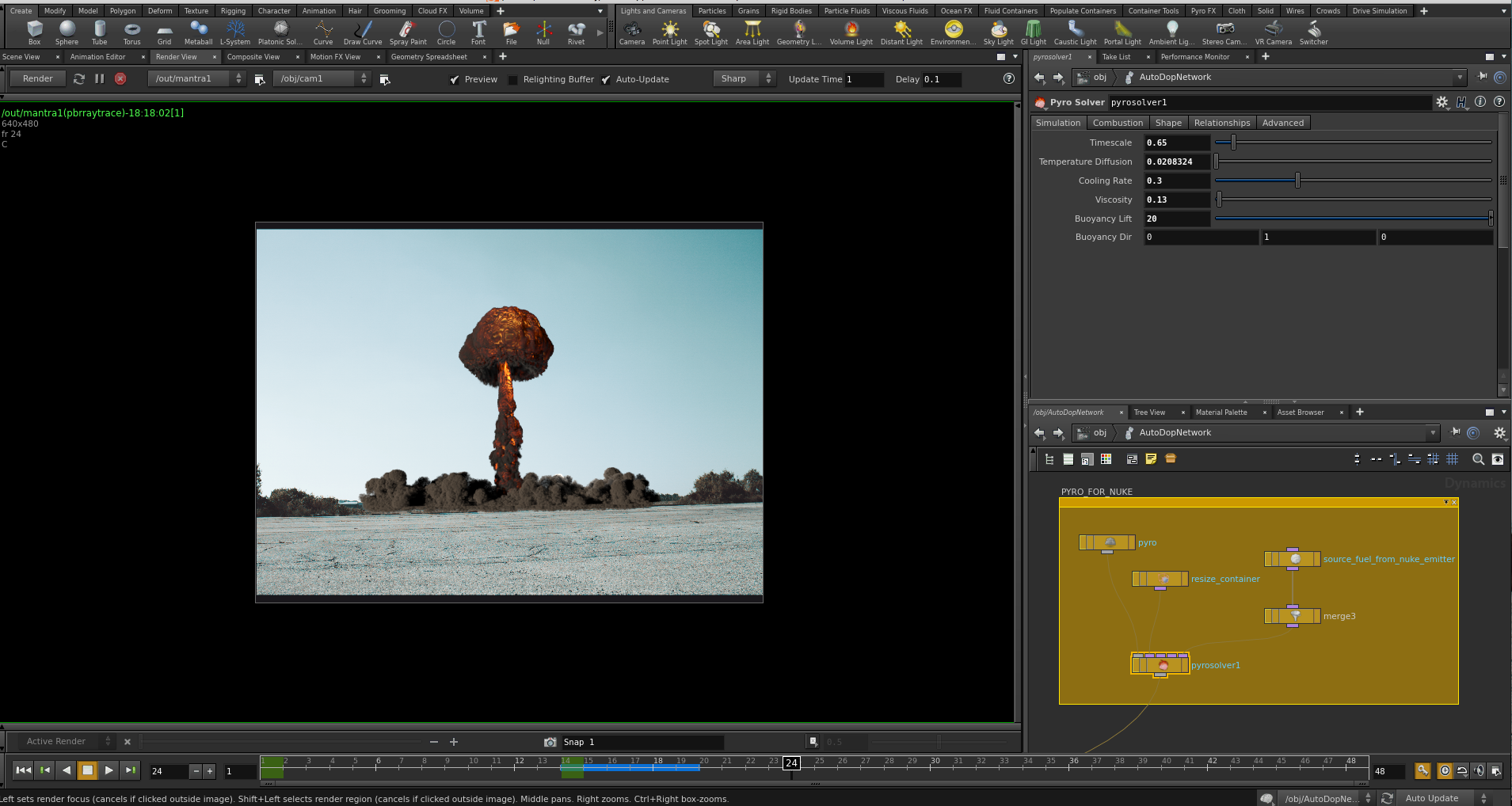

hey guys after my last post on asking for help on how to up -res my sim i decided to rebuild it from scratch with higher resolution. Now i'm trying to retime the sim to slow down the nuke explosion. i tried time scale. but it changes the look of the sim. i've never used time shift or time blend nodes, can someone please explain to me where in the autodop network from the screenshot below i would put those nodes and at what setting i should start with. Thanks

Go inside Pyro import node. Cache your sim from import pyrofields node. Then place a timeshift node under import pyrofields node. Now edit the expression at frame parameter to $F*0.5
This will slow down your sim 100%.

Thank you vijay
