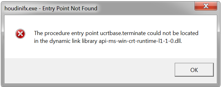

Thanks Jeff. I haven't tried this since Houdini won't open in my laptop at home (The error message has been attached here. Any idea?)
