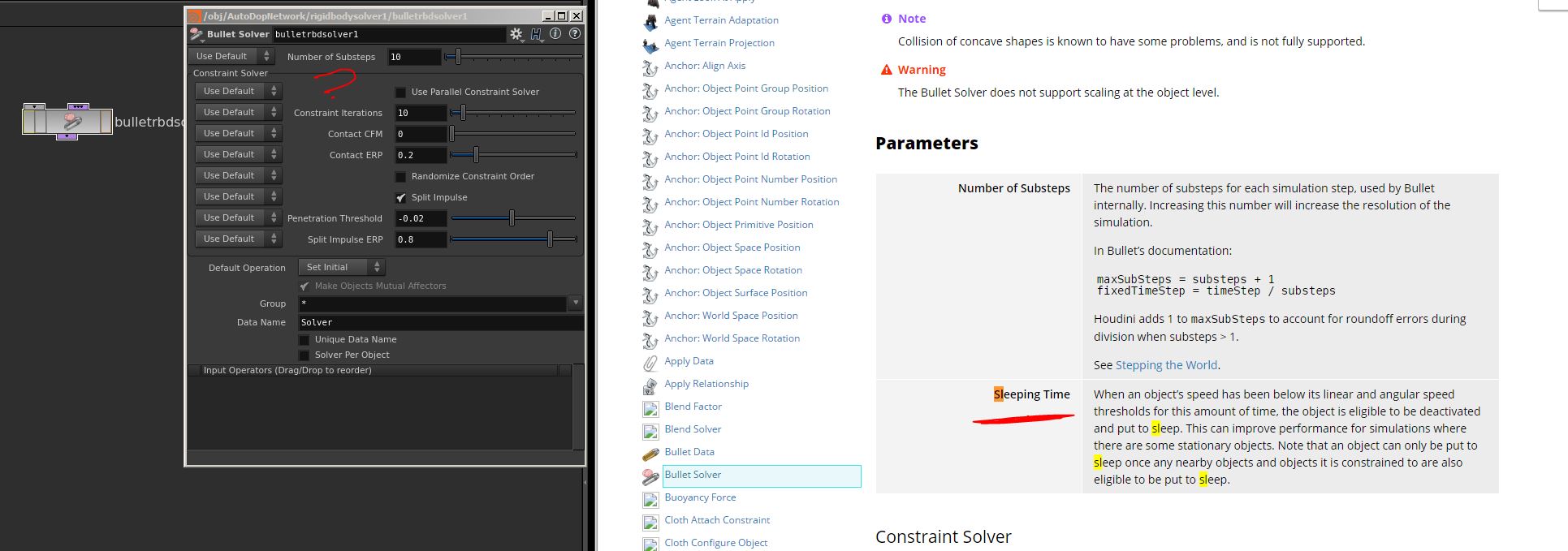

Uuups… it's the sleeping time… increase it or set it to 0
Edited by matthias_k - Oct. 7, 2016 11:00:58

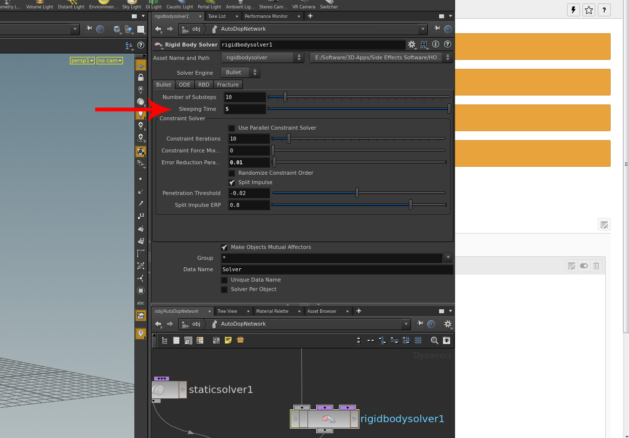

Please have a look at the image above, I've corrected my prev. post. In the “rigidbodysolver1” Tab -> “Bullet” -> “Sleeping Time”
Edited by matthias_k - Oct. 7, 2016 11:19:19

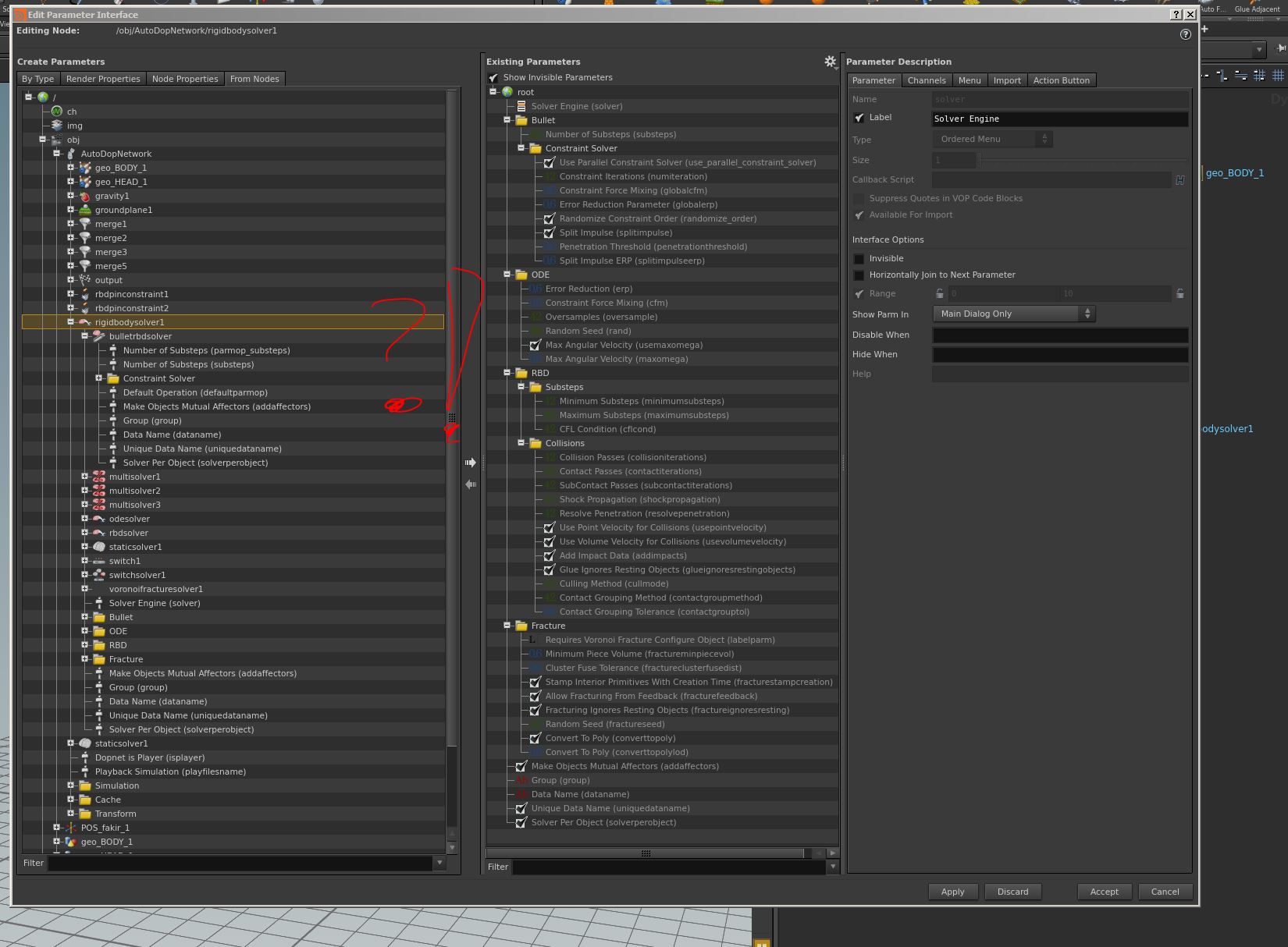

Windows -> Operator Type Manager -> Configuration Tab -> “Display Menu of All Definitions” Then You should have the Option.
Edited by matthias_k - Oct. 7, 2016 11:34:34

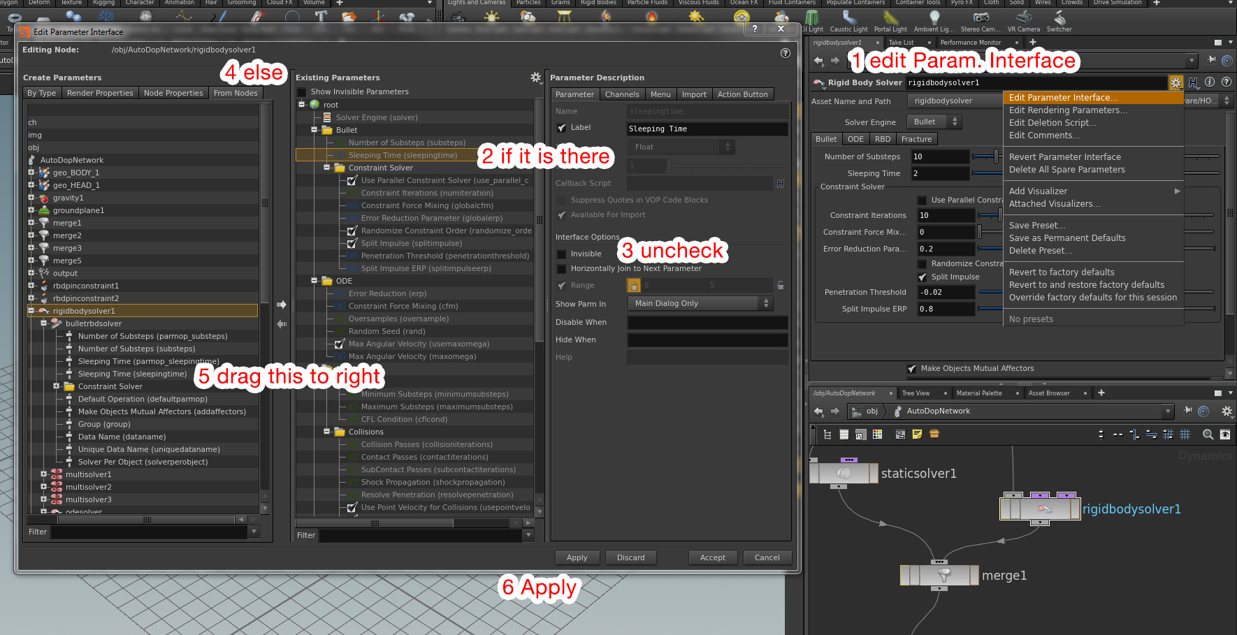

Alternative do this one

Ahhh, open the “Bullet” folder… or search in the “Filter” field below for “Sleeping”

this is a fixed version, maybe then you have the params
HIPsim_constrain-0-sleeping-time.hip (303.8 KB)

Alternative if you do not find the parameter at all…
