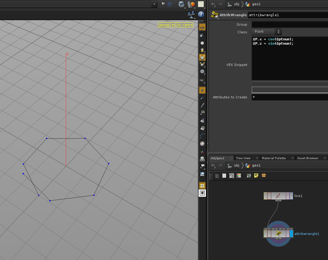

Moin,
sin(6) is not what you _want_, but what you are _using_
Try this:
Comment: The “2*pi” is for the radiant value you need to use with trigonometry in VEX, the “ch(…” is to get the number of points from your line-object, so that you can change the resolution.
I hope this helps!
Marc
Try this:
@P.y=0.0; @P.x=sin(@ptnum*2*3.14159265/(ch('../line1/points')-1)); @P.z=cos(@ptnum*2*3.14159265/(ch('../line1/points')-1));
I hope this helps!
Marc

It's clarifyng for me. So why substract 1 value from radiant value?
I'm triying to build a small digital asset, that include a bit more complex curve equation than circle. However due I'm not having successful in that, I have try before with a more elementary thing like a circle equation.
At this point, I have reached to generate the curve shape by increasing number of points, but I think is not good solution because points aren't properly sorted.
I going to try dividing by line/points like you example for circle, Marc.
- malbrecht
- 806 posts
- Joined: Oct. 2016
Moin,
I am not subtracting from the radiant. But your point index only runs from 0 to point-count minus 1, so if you don't want a gap, you have to also reduce the max value by 1. Else you only ever get to the last but one point.
Take a piece of paper and do it manually once. I always find that helpful.
Marc
