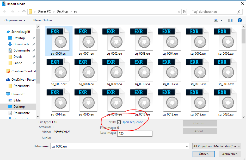

I am not sure what the issue with Vegas was that you experienced. I just did a quick test, rendered out a sequence of 16bit EXR (though not using Houdini) and imported them (screenshots of the import requesters attached) into the current version of Vegas (Magix did do fix some bugs and overall added some improvements).

Yeah I have the same settings as your screenshot. I tried some variations like setting frame rate to 24 ( same as my houdini file ) and also using timecode in file. Used ‘Video 1’ stream too.
