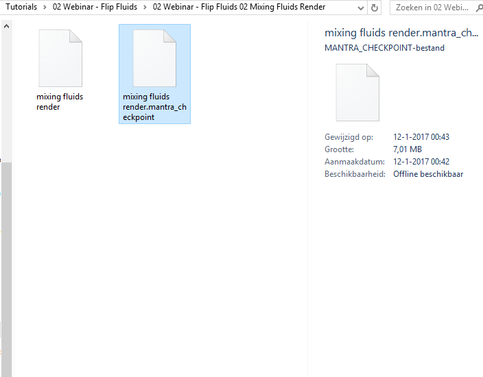

I recently started working with Houdini, and have not yet been able to create any image files, though rendering seems to work fine. I added some screenshots (H1, H2, H3) as attachments to explain.
H1: I have set up a ropnet with these settings. If I press “Render to Disk”, no files are created.

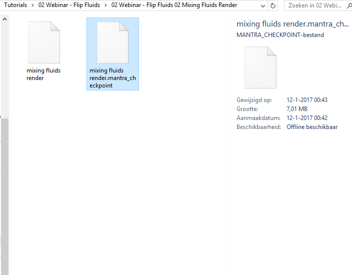

H2: The folder I'm rendering to looks like this afterwards. No jpegs, just those two files.
H3: I tried rendering to MPlay first, and then exporting from there. Afterwards, it says it created the files, but the folder is still the same as H2.
What am I doing wrong?
Tim

in the Output Picture, are you giving the file name an extension > "mixing fluids render.jpg" ?
also - DO NOT use spaces in your file paths/names…it might work but it WILL cause you problems.

Hi Michael,
Thank you for the reply.
I needed to add $F and .jpg. Coming from C4D and other applications where those things are done automatically makes it confusing sometimes.
