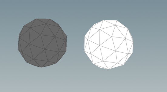

Hi All,
Just wondering if there's a way to view your scene in constant view without lighting?
I found that if I turn lighting off it looks constant but it is always a bit darker.
The one on the right has a constant material applied.
Applying the constant material works from the object level but when I dive into SOP level to edit the object it goes back to the darker version so it's kinda hard to get feedback on how the colours are working.
Any ideas? Thanks,
Pete

Could you check your Viewport Display Options (press D on the viewport), go to the Effects tab and check the Default color values?
I adjusted my settings, these are not the default values. But it gives me the actual color.

Awesome, thanks for that!
