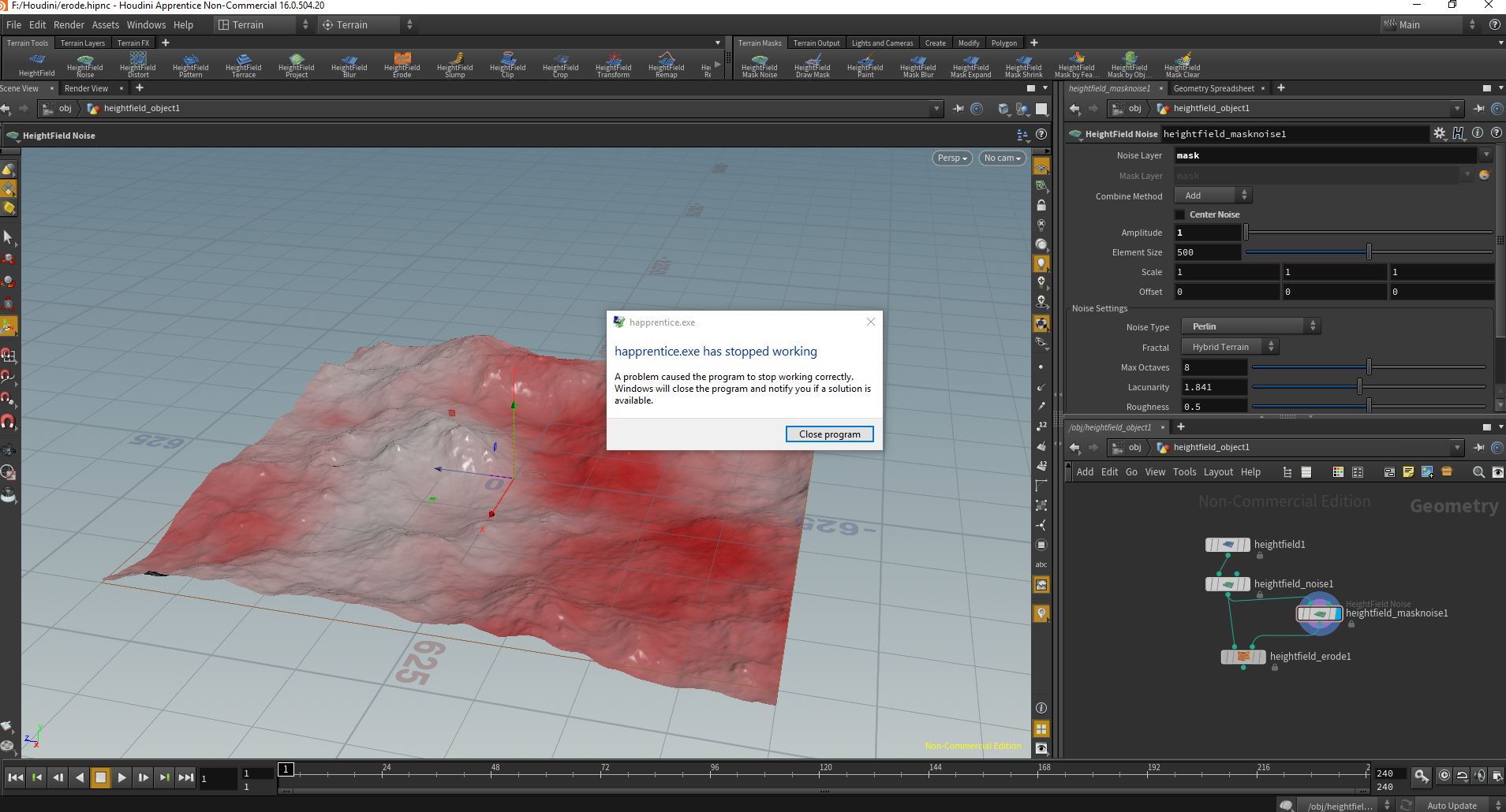

I'm using the Houdini Apprentice license, and currently if I try to attach a heightfield to the Heightfield Erode node and try to look at the parameters Houdini crashes instantly. Has anyone else experienced this issue? Is it possible I'm just trying to use it incorrectly? I've included screenshots of the basic setup I tried, everything works fine until I actually click on the Erode node.

Looks like the screenshots didn't make it through. Could you try posting the HIP file from just before the crash, so that we could try to investigate?

Sorry, I can't seem to reproduce the crash easily, so without a HIP file, you'll have to be more specific about what steps lead to the crash, e.g.:
0) Open Houdini
1) Switch to the Terrain desktop
2) Ctrl+LMB click on the HeightField shelf tool
3) Alt+A in the viewport to show all
4) Ctrl+LMB click on the HeightField Noise shelf tool
5) Ctrl+LMB click on the HeightField Erode shelf tool
6) Ctrl+LMB click on the HeightField Mask Noise shelf tool
7) Unwire heightfield_masknoise1 in the network editor by LMB shaking the node
8) Wire the output of heightfield_noise1 to the first input of heightfield_masknoise1
9) Wire the output of heightfield_masknoise1 to the second input of heighfield_erode1
10) Set the display flag to heightfield_masknoise1
That comes as close as I can figure out to what's displayed in the screenshot, but the noise looks different in your screenshot, and it doesn't crash, so something else is probably different. It might also be a video driver issue. What graphics card and graphics driver version are you using?

I'm using Windows 10, GTX 970 with 378.66 drivers, i7 3770
The crash happens for me if I just add height field, add noise, and add erode. No matter what configuration the erosion crashes
It seems to be an OpenCL issue, I installed the Windows SDK debug tools to see if it could provide any additional help and it came through. I'll post the crash report if that's any help. I added a Pyro node and when I clicked “Use OpenCL” it also crashed immediately.

Edited by Thater - Feb. 22, 2017 13:43:17

- Thater
- 4 posts
- Joined: Sept. 2015
Artye
Bet it's trying to use the Intel® HD Graphics 4000 as a OpenCL device.
I think you're right, I actually solved the issue following your advice in the other OpenCL thread
https://www.sidefx.com/forum/topic/48276/ [sidefx.com]
Thank you so much! I wish it were easier to set the openCL device, there should be something in the Preferences window.

Hi, I have a same problem about Heightfield Erosion node.
I got following message when it crashes;
Invalid OpenCL platform vendor (HOUDINI_OCL_VENDOR): NVIDIA Corporation. Falling back to built-in CPU OpenCL driver.
TBB Warning: The number of workers is currently limited to 7. The request for 1813085199 workers is ignored. Further requests for more workers will be silently ignored until the limit changes.
7640: Fatal error: Segmentation fault
Then, I found this forum and tried to put following into the “houdini.env” as I reference the forum(https://www.sidefx.com/forum/topic/48276/ [www.sidefx.com] );
HOUDINI_OCL_DEVICETYPE=“GPU”
HOUDINI_OCL_VENDOR=“NVIDIA Corporation”
However, Houdini still instantly crashes when I use erosion node.
Could anyone give me advice, please?
I use…
Houdini apprentice version
Windows 7
Quadro K1100M
Thanks!
