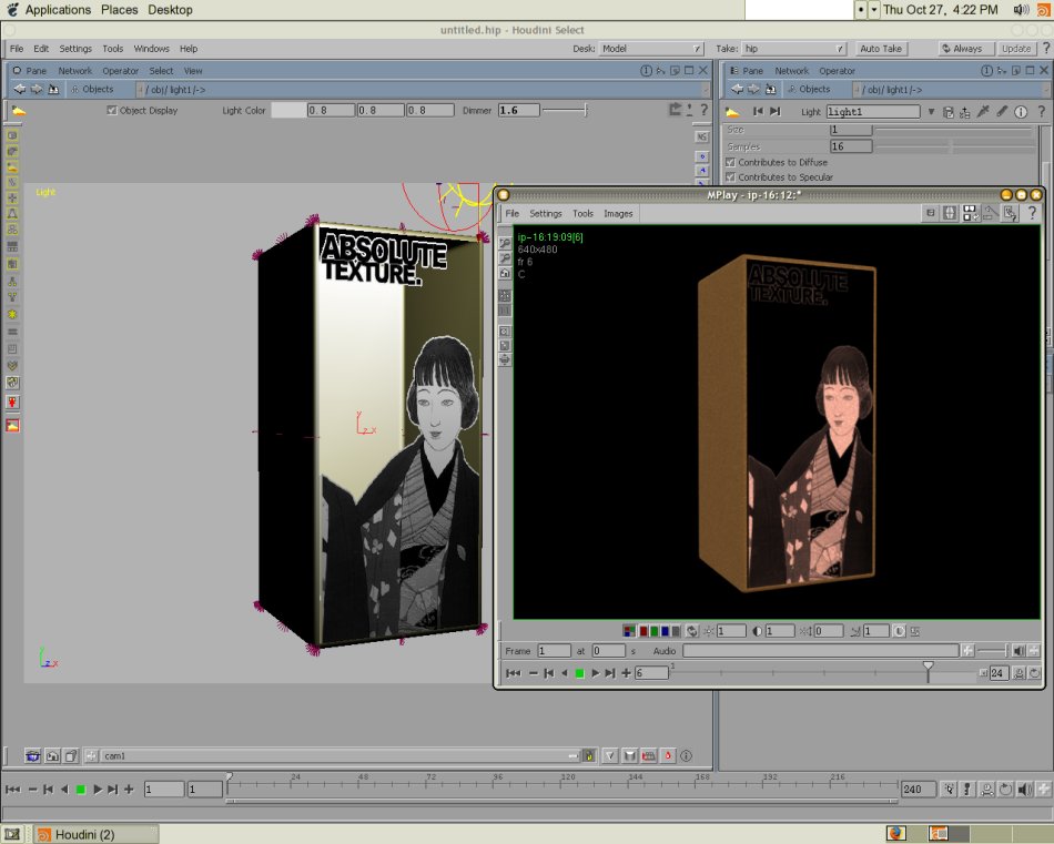

With the image shown above, that's something i trying to archive.
I just modeled a bottle with a vex glass shader.
I need to map some texture with transparency on top of the glass surface.
question one: I have sorted out the surface where i want to map my texture in SOP with a group op and a uvtexture op. Then, i created a vex layered shader in SHOP and loaded a texture map in the base. I also set the texture tints to diffuse. And then i load a second texture map in layer2 as an alpha matte with texture tints set to alpha. And compositing set to over.
but it doesn't work. U guys have any suggestion? That's any other way to do it? Thanks in advance.

You don't need the second texture map, just make sure the one in the base layer map has the alpha channel embedded in it -e RGBA not just RGB, houdini will then automatically use the alpha channel of the image to work out which bits are transparent.
and yea, should set the texture map's tint to diffuse and alpha?

Hi jeonado,
Yep, you should set the Texture Tints to “Diff + Alpha”.

thanks, steven. I set texture tints to “Diffuse” at first, because it is a default setting. Suprisingly, it works as well.
One thing i noticed that the particular faces with texture map + alpha looks funny on the viewport. But it looks fine when i rendered out.
It only shows the texture map on the viewport, and the transparency area gone empty. Is that the openGL problem?

jeonadoThe difference between “Diffuse” & “Diff + Alpha” is whether should the shader use the Alpha in the texture map to set the Alpha value. Try it on a simple grid & after it renders, look at the alpha of the rendered image.
One thing i noticed that the particular faces with texture map + alpha looks funny on the viewport. But it looks fine when i rendered out.Are you displaying the UV Texture SOP or the Shader SOP if you have one in your network? Maybe a screen grab will better show what the problem is.

Hi Jordan,
With regards to the missing area, there is an OpenGL tab in the VEX Layer Surface shader. Go to the tab & uncheck the “Transparent Texture Alpha” toggle.

regarding to the image above, the texture meant to be a sticker which stick on top of the surface. So the transparent area suspose to fill up with the surface shader. But now it become empty.
Question: I was using group sop to select the particular faces where i want to map the texture and another group sop to select the whole geometry for diffuse color.
Then i loaded a shader sop and assigned the number of surfaces to 2 group.
One for the diffuse shader another one for the texture map.
Since the texture map is embedded with an alpha channel, the transparent area gonna be empty.
How should i fill up the transparent area with the same shader i applied to the whole box?

ok, guys. a better description of my problem with an image attached below.
I just want to fill up the alpha transparent aread.
