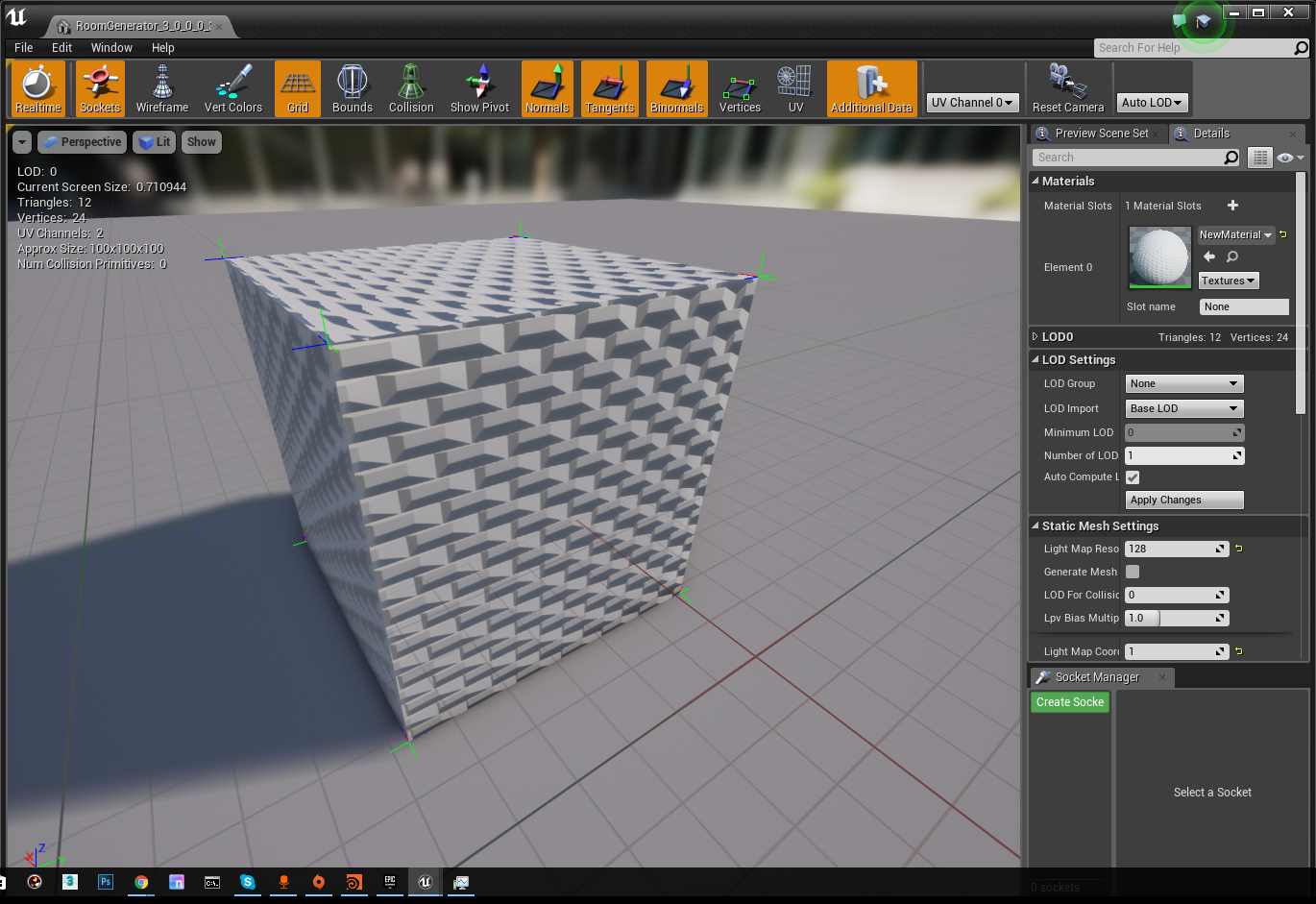

Hi I have problem with digital asset and parallax occlusion when I use normal sop or boolean sop. First on video is without normal sop second with.
Joined: Aug. 2015
Normal sop change tangent and binormals
Screenshot 2017-04-08 15.59.34.png (920.9 KB)
Screenshot 2017-04-08 16.00.14.png (964.5 KB)
Joined: Aug. 2015
Ok I do some tests this problem is everytime when mesh has normals its will by becose houdini has different AXIS system from unreal?
Joined: Aug. 2015
OK I find solution after X hour experimenting Project Setting>Houdini Engine>Static Mesh Build Settings>Recompute Tangents>Always
Joined: Aug. 2015
oh when recompute tangents i loos normals from houdini
